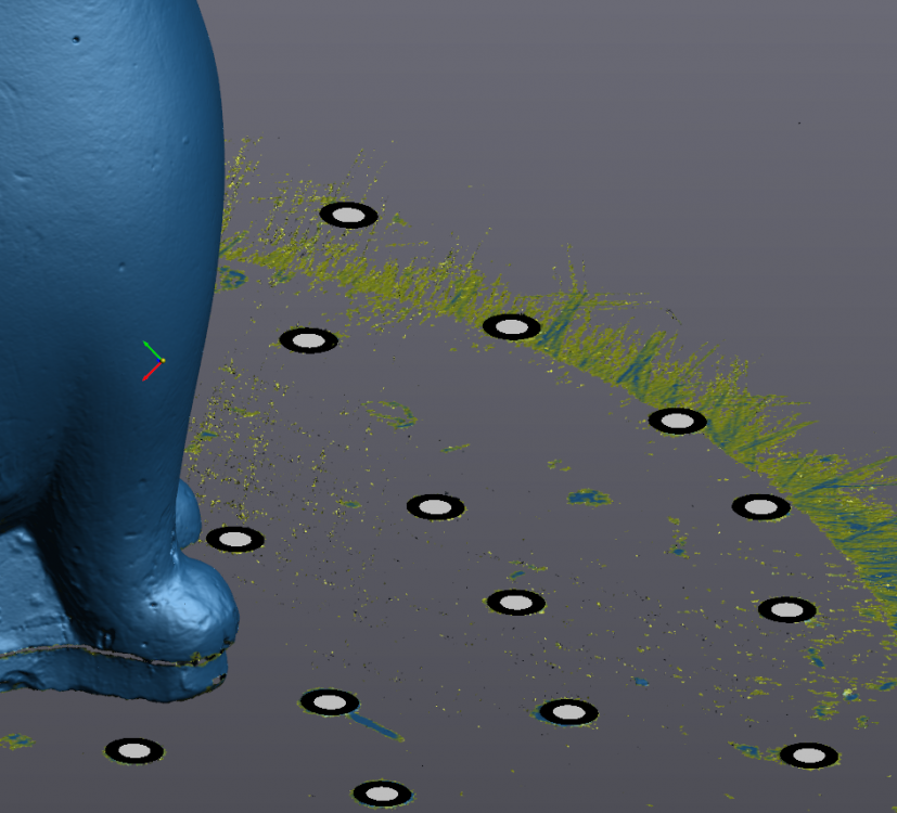

[St...] Posted August 31, 2024 Share Posted August 31, 2024 It is difficult to determine if enough data has been captured while scanning. It would be helpful if a preview mesh was created on the fly, rather than showing only the pointcloud. Link to comment https://qualityforum.zeiss.com/topic/4233-scan-visualisation-t-scan-hawk-2/ Share on other sites More sharing options...

[Th...] Posted September 3, 2024 Share Posted September 3, 2024 We're looking at moving into the Zeiss system and this something I also noticed during our evaluation. Creaform provides a real-time meshed view of captured data that I think is quite good. The amount of data that's been captured for an area is also reflected by the base color of the mesh. Yellow for low quality or not enough points and progressing to teal for an adequate amount for the selected resolution. With inspect the points of the captured cloud are very uniform in appearance so it's sometimes hard to discern if all the details in a highly complex surface are being captured. This was more of an issue when working with the Hawk2 and standing several feet from the monitor. I think even just a different lighting preset or rendering parameters could be applied to the points during capture. Being able to see shading on surfaces better through the use of more contrast or reflectivity of the rendered point could help. Other options like a change in color based on distance from a selected clipping plane could be nice. The example below is the type of scan in progress rendering I personally think is quite useful. It's very easy to see where holes exist and discern areas of noise. In most other aspects I've been very impressed with the Zeiss software. I can see how the current system works well for the structured light devices but is less optimized for handheld laser capture. Link to comment https://qualityforum.zeiss.com/topic/4233-scan-visualisation-t-scan-hawk-2/#findComment-12369 Share on other sites More sharing options...

[Na...] Posted May 5 Share Posted May 5 Hi all, with Inspect 2026 the visualization was improved. The splats will now grow with better confidence, so the preview does reflect the end result much better. ZEISS Portal (Zeiss Portal -> Academy Metrology -> Free Tutorials -> What’s New 2026 (English), in case the link is not working for everyone) Link to comment https://qualityforum.zeiss.com/topic/4233-scan-visualisation-t-scan-hawk-2/#findComment-150074 Share on other sites More sharing options...
