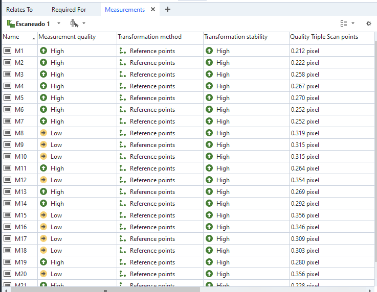

[Ir...] Posted September 3, 2024 Share Posted September 3, 2024 Hi, As we can see in the image below, the interface of GOM shows whether the quality of each measurement is high or low. Is there any way I can access that information in a script? What would be the code to obtain the measurement quality of a specific measure? Link to comment Share on other sites More sharing options...
[Ma...] Posted September 4, 2024 Share Posted September 4, 2024 Hello Irune, The token is not listed in the Insert->Element Value dialog, but you can access it via gom.app.project.measurement_series['Scan 1'].measurements['M1'].explorer_measurement_quality Best regards, Matthias Link to comment Share on other sites More sharing options...
