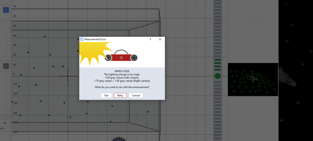

[El...] Posted September 4 Share Posted September 4 Hello, I am using the GomScan1 200 lens device. When I scan, I get the error you see on the screen. What is the reason? What is the solution for this problem? Link to comment Share on other sites More sharing options...
[Je...] Posted September 5 Share Posted September 5 Hello Elif, is there any possibility that sunlight affects your measurement? Best regards, Jens Braun Link to comment Share on other sites More sharing options...
[El...] Posted September 5 Author Share Posted September 5 No. I use store curtains in my office. But I don't work as a single person in the office. Does movement affect ? Link to comment Share on other sites More sharing options...
[Je...] Posted September 5 Share Posted September 5 I guess those let light through? The message says that the lighting conditions change during the measurement. Movement is not an issue here. Can you test it in a dark room to check if the light that goes through causes this issue? Link to comment Share on other sites More sharing options...
[El...] Posted September 5 Author Share Posted September 5 But I tried. no result Link to comment Share on other sites More sharing options...

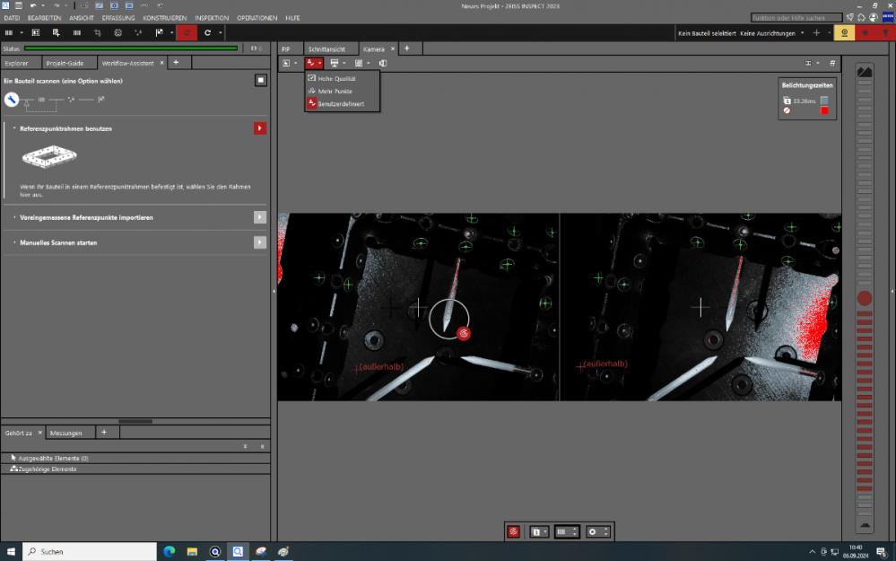

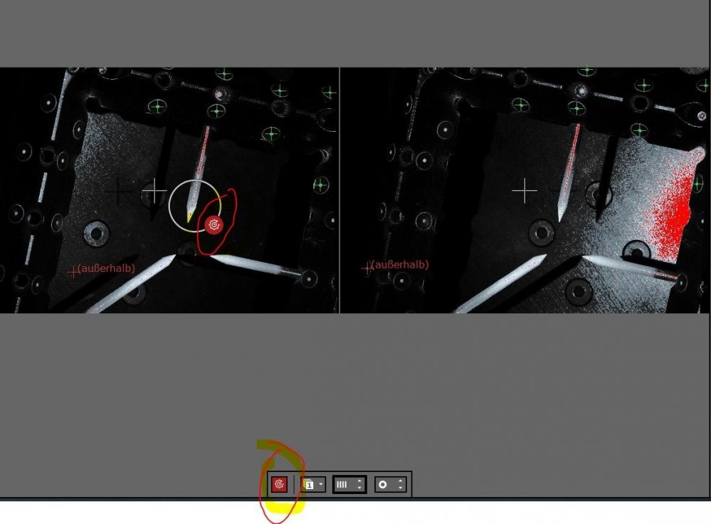

[Ch...] Posted September 6 Share Posted September 6 Hey. try to change your Kamera setttings. Kamera > Qualität > Userdefined . Set a spot and press the button. You can set the Focus ,so the software optimizes the light for the spot you set. Maybe someone changed /played with the settings of the Kamera. Link to comment Share on other sites More sharing options...
[El...] Posted September 9 Author Share Posted September 9 I tried. no result. Is there a definitive solution? Link to comment Share on other sites More sharing options...
