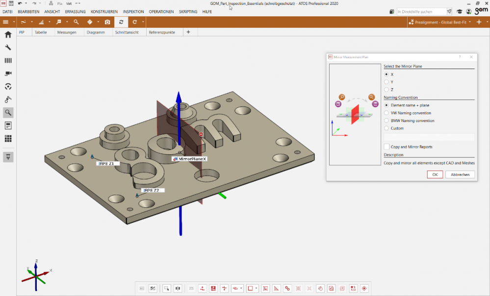

[DR...] Posted September 14, 2021 Share Posted September 14, 2021 Hello , Is it possible to create automatically the program of a symmetrical part ? thank you ! Link to comment Share on other sites More sharing options...
[Na...] Posted September 14, 2021 Share Posted September 14, 2021 Hello Dridi, there is a script in a package for this: https://connect.gom.com/display/GPF/Mirror+Project+Elements It can also be installed via the package symbol in software. Regards, Nanno Link to comment Share on other sites More sharing options...

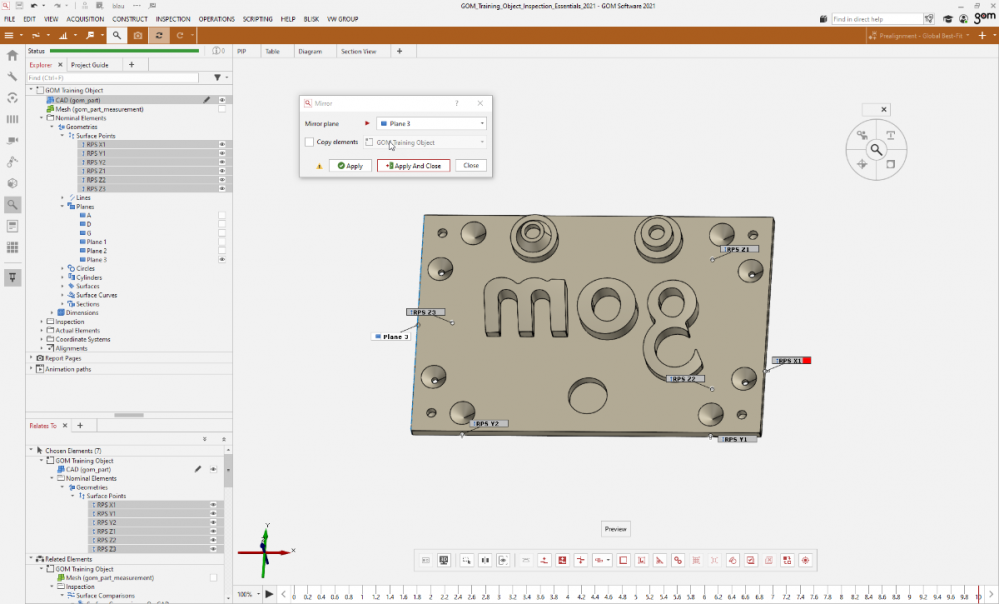

[DR...] Posted September 14, 2021 Author Share Posted September 14, 2021 HELLO Mr Nanno; Thank you very much ? , I find it in my Gom 2020 . but sorry I didn't understand how it work ? I create a Mirror but I don't now where I can find the new program . could you support me please . Thank you in advance Link to comment Share on other sites More sharing options...

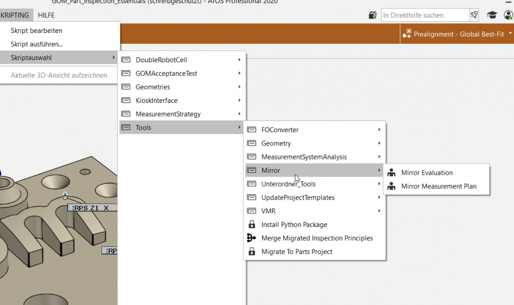

[Na...] Posted September 15, 2021 Share Posted September 15, 2021 Hello Dridi, you find the script under Scripting -> Tools -> Mirror. Then select a mirror plane in the dialog and select the elements you want to mirror. There is also a function without a script included in the software: Operations -> Elements -> Mirror. Regards, Nanno Link to comment Share on other sites More sharing options...
[DR...] Posted September 27, 2021 Author Share Posted September 27, 2021 (edited) Dear Mr Nanno, thank you very much , it is so easy with Gom inspect! Edited September 27, 2021 Link to comment Share on other sites More sharing options...
[Fr...] Posted September 5, 2022 Share Posted September 5, 2022 Hallo zusammen, wo finde ich genau dieses Script in der Inspect 2021? Ganz speziell mit der Funktion BMW Naming convention bzw. VW Naming convention. Hoffentlich ist das nicht entfernt worden! Danke Mfg FS Link to comment Share on other sites More sharing options...
[Na...] Posted September 5, 2022 Share Posted September 5, 2022 Please sign in to view this quote. Hallo, das wurde oben schon beantwortet: Please sign in to view this quote. Oder in der Suite anmelden und über das Paketsymbol in der Software installieren. Gruß, Nanno Link to comment Share on other sites More sharing options...
[la...] Posted Wednesday at 12:24 PM Share Posted Wednesday at 12:24 PM Hallo, das Thema ist schon älter und ich kenne das Script auch. Leider kann ich es in einer neuen Installation nicht finden oder nachinstallieren. Der gepostete Link scheint nicht mehr zu funktionieren, kann jemand das Script nochmal zur Verfügung stellen? Danke Link to comment Share on other sites More sharing options...
[An...] Posted Thursday at 06:41 AM Share Posted Thursday at 06:41 AM Die App gibt es im "ZEISS Quality Software Store" im Bereich der "ZEISS Apps" unter dem Namen "Mirror Project Elements". Für die Nutzung des Software Store muss man sich dort anmelden. Link: https://software-store.zeiss.com/de Link to comment Share on other sites More sharing options...
