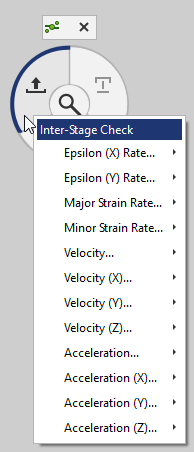

[em...] Posted January 6, 2021 Share Posted January 6, 2021 Hi every body, I want to know is it possible to get the strain rate from 2-D digital image correlation in this software? thanks in advance Link to comment Share on other sites More sharing options...

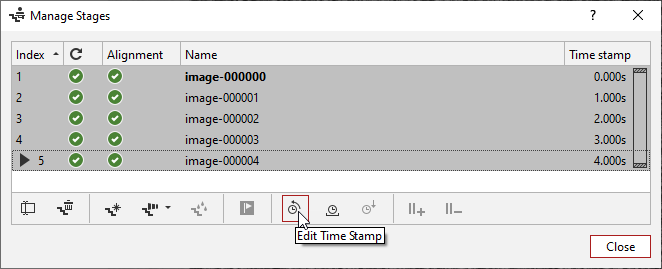

[Iv...] Posted January 7, 2021 Share Posted January 7, 2021 Hi Emadein, yes it is possible. Please be aware that the rate depends on the time delta of your stages. Maybe our Webinar will help you, too.→ Youtube GOM Webinar 2D Greetings, Ivan Link to comment Share on other sites More sharing options...
[Th...] Posted January 14, 2021 Share Posted January 14, 2021 Just an additional comment: If the measurement was done with GOM Snap 2D or another GOM System or you import a movie/video file, the time delta of your stages (Ivan mentioned) should already be set. If you import an image series, the time delta of your stages is set to 1s by default. It can be adapted by "RMB on the time line -> Manage Stages -> Select all stages in the pop up dialog -> Edit Time Stamp". The strain rates are available as "Inter-Stage Checks" in I-Inspect: Link to comment Share on other sites More sharing options...
