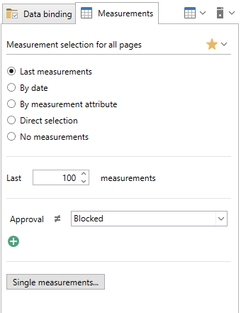

[Kr...] Posted September 25, 2024 Share Posted September 25, 2024 I'm having trouble increasing the number of results on the Trend Chart from 25 to 31 or more. I'm working with V. 2021. I would appreciate any help you could offer. Link to comment Share on other sites More sharing options...
[Na...] Posted October 22, 2024 Share Posted October 22, 2024 Hi Kris, I think the max. number is determined by the license you are using. Nanno Link to comment Share on other sites More sharing options...
[Si...] Posted October 25, 2024 Share Posted October 25, 2024 Hi, Can you get the ProcessProtocol to show more than 10 Measurements? Im running a autorun with 56 parts... - Simon Link to comment Share on other sites More sharing options...
[An...] Posted March 10, 2025 Share Posted March 10, 2025 PiWeb Reporting Plus should allow you to do 1000 runs per program and PiWeb Basic would be only 10. Here is a link with more details on the different options. https://portal.zeiss.com/knowledge-base?id=1257064 So you being able to do at least 25 says you have PiWeb Plus at least. My guess is if you did a revision update to the program (program name changed) then the database for PiWeb actually will reset with the new name and maybe that is why you might be missing a few of your runs? Or if you have some filter in your settings hiding the other data? Link to comment Share on other sites More sharing options...
[An...] Posted March 10, 2025 Share Posted March 10, 2025 When viewing a PiWeb report, there are two tabs on the left hand side of the report page: Data Binding, where you select which characteristics you'd like to view, and Measurements, where you select which measurements to view. If you simply want to view more total measurements, ensure the "Last Measurements" radio button is selected and enter the number of measurements you want to see. In the image below, I have chosen to view the last 100 measurements. To amend Anthony's answer slightly, when you create a new measurement plan for the same part(via a "Save As" for example) the PiWeb Database for that part is not reset. Rather, a new .dfs file is created for that new plan. The old data still exists, you may just have to dig slightly to find it. The new plan cannot see the old data. If you have PiWeb SBS (I believe this is called PiWeb Essential now) or PiWeb Enterprise, then combining data from multiple programs is quite. With Reporting/Reporting+, two measurement plan databases cannot talk to one another. Link to comment Share on other sites More sharing options...
