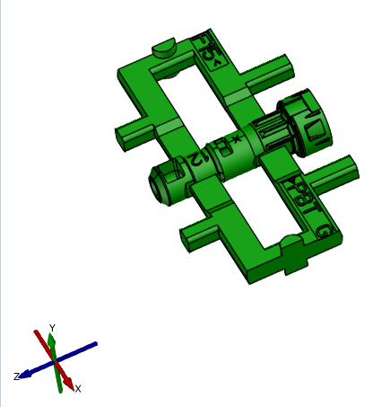

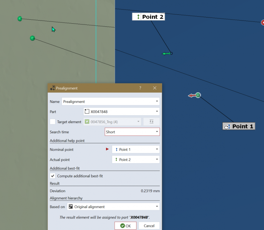

[ma...] Posted October 1, 2024 Share Posted October 1, 2024 (edited) gom.script.sys.edit_creation_parameters (element=gom.app.project.alignments['Prealignment']) gom.script.sys.edit_creation_parameters ( actual_point_1={'interpolated': True, 'normal': gom.Vec3d (0.3390497863, 0.9389895797, -0.05782522634), 'point': gom.Vec3d (16.2586519, -1.642760776, 6.281157939), 'target': gom.app.project.parts['Part'].actual}, element=gom.app.project.alignments['Prealignment'], nominal_point_1={'interpolated': True, 'normal': gom.Vec3d (-1.0, 0.0, 0.0), 'point': gom.Vec3d (-0.8499999983, -0.01679463386, -0.3046244892), 'target': gom.app.project.parts['Part'].nominal}) gom.script.manage_alignment.set_alignment_active (cad_alignment=gom.app.project.alignments['Prealignment']) I'd like to change the point (which is in red at the top here) in my script. Because the scans are not always in the same place when they are loaded into the gom inspect software. The question is how can I change this. Now I can't do this Edited October 1, 2024 Link to comment Share on other sites More sharing options...

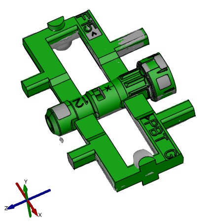

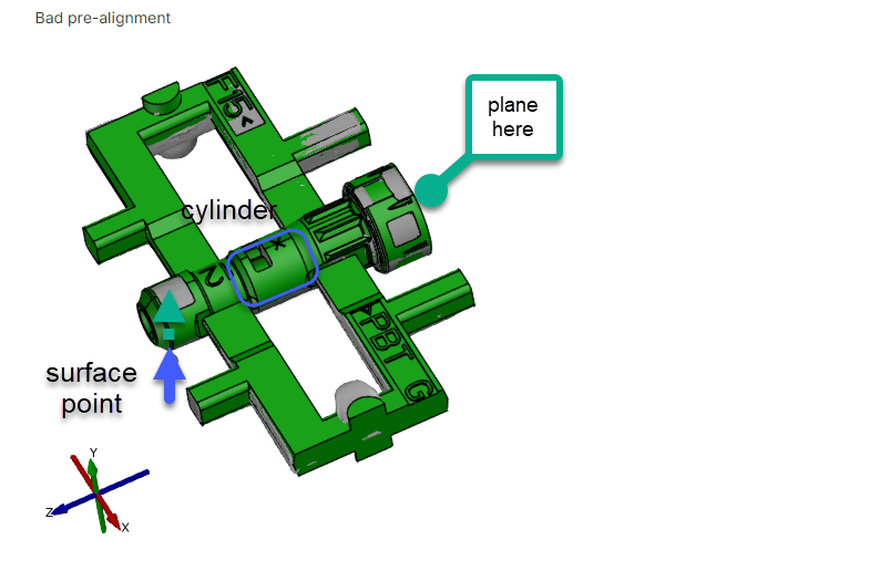

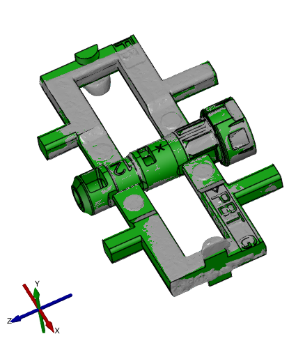

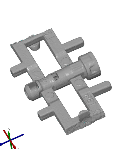

[ma...] Posted October 3, 2024 Author Share Posted October 3, 2024 This is the CAD model The scan part if i do pre-alignment the part turns 180° it's not always correct. Bad pre-alignment Good pre-alignment The problem is that no scan is on the same place. I do this with scripting there are to many parts. If i do it with point next scan part is the point in the pre alignment not correct so he must first turn 180 degrees . Link to comment Share on other sites More sharing options...

[Na...] Posted October 7, 2024 Share Posted October 7, 2024 Hello, here is a techguide article for the alignment with reference points: ZEISS Quality Tech Guide Another idea could be the cutout at the Z+ end of the part, which could be used for an alignment by geometry elements though. A nominal surface point (intersection with mesh) at this position will intersect the mesh no matter if the part is "flipped" 180° or not. An alignment with a cylinder with Z-axis, plane with Z normal and the point as third element should align the cutout correctly. It will not be 100% perfect but you can use this alignment as a starting point. (The actual surface point should have alignment required active) Link to comment Share on other sites More sharing options...
[Ja...] Posted October 10, 2024 Share Posted October 10, 2024 (edited) Nice idea nanno, but i think part of the issue here is that there is no stable start alignment in which to pick up these geometries from in order to lock to the target. Here is an off the wall idea involving code building on this concept .... Create the geometries as suggested and make a prealignment . Create an alignment using plane described and cylinder that will be picked up and any surface point random point In code evaluate the dn of the value in the pocket. If greater than a certain value , say half the height of the pocket it would be reasonable to assume the part is 180 degrees out of rotation . Create a further alignment flipped by 180, locking to the cylinder axis Mesh can be exported , then brought into project template with starting alignment as original alignment , then jump directly to the geometrical alignment described. A bit long winded and unconventional but maybe might give you some possibilities! Edited October 10, 2024 Link to comment Share on other sites More sharing options...

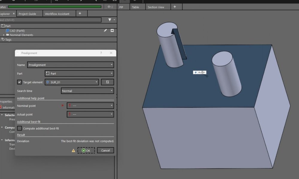

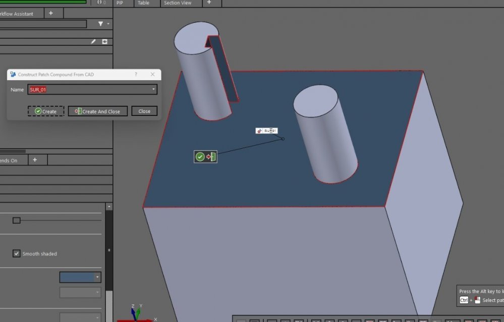

[Ti...] Posted October 13, 2024 Share Posted October 13, 2024 (edited) I would use target surfaces. From my experience less is more, and sometimes I've spent 10 hours on finding the correct surfaces to click as a target surface. Below you can see I am selecting a unique key cutter on one cylinder so they don't get confused and a nice large plane to level on. One you create the nominal surface, you apply a 'no measuring principle' to it. Here is the secret sauce, there is a bug in the software. If you have a mesh loaded in your program and try to create a 'prealignment' then inside the prealignment select the 'target element' checkbox and use this surface you created the program will error out and not let the part align. The workaround for this bug is to delete the mesh and do this prealignment without a mesh. Then you will get a yellow error message but it will allow you to create the prealignment...then you bring in your mesh and it will work. I suggest using long for these most of the time, but play with short, medium and long, and play with the surfaces you think are unique and at least one robust surface. Edited October 13, 2024 Link to comment Share on other sites More sharing options...
