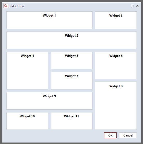

Hello,
Is it possible to interact with the creation of a dialog from a script? For example, can you define the columns and rows of a dialog in a scripting environment before calling the dialog?
To illustrate, I’ll use a simple example.
Giving these values to these variables (left image) I want to create the dialog of the right image.
image.png.52a8dd0095d305fa44f50cbbb600e52a.pngimage.png.a72fbd45df71cfb299b58874efe11183.png
If the values given were different, the dialog would also change. See the image below.
image.png.8cf9d0cd966a34ea5d168a3dc86d7f04.pngimage.png.75909f0242a50832674669c3f2509f63.png
Is there any way I could control the dialog in this manner?
Thank you in advance,
Irune
Hello Irune,
Yes, this is possible. When you insert a dialog into the script, you can select the option "Embedded into script". You will notice that the dialog definition is a Python dictionary, which is passed to gom.script.sys.create_user_defined_dialog (). Ususally, this dictionary is created with the Dialog editor and used as a constant, but it is possible to modify it before calling gom.script.sys.create_user_defined_dialog ().
For each widget in the dialog, you will see a key/value pair for "rows" and "columns" which defines its position in the dialog window. The dialog window's total number of rows and columns is calculated internally.
You can create widgets by adding entries in the dictionary by your script accordingly.

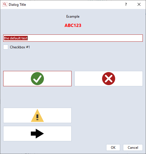

I have to move on to other tasks, but I think I've figured out a bit of how the software is interpreting JSON code and building dialog boxes. Hopefully a developer or someone more knowledgeable can chime in, however I believe this is how things are working:
1) Everything appears to originate from the top left corner of the first available row.
2) For any widget(s) you wish to add, first you define the columns it will span.
    - If you wish to add just one widget for that given row, simply add the one widget. The next widget or widget(s) will be in the next row down.
    - If you wish to add multiple widgets to the same row, you need to build a list of the widgets that belong in that row. The next widget or widget(s) will be in the next row down.
I'm going to share some of my code below to give you an idea of how you can put together JSON based dialog boxes. I will also share commented code that can help teach you how the rows and columns are interpreted.

blankForm = []
blankForm.append(addContinuousText())
blankForm.append(addInput('the default text'))
blankForm.append(addCheckbox('Checkbox #1'))
blankForm.append(addVerticalSpace(1, 5))
aButton = addSingleButton(1,'ok')
buttonsAsRows = addButtonList(aButton, 2, 'cancel')
blankForm.append(buttonsAsRows)
blankForm.append(addVerticalSpace(2, 25))
blankForm.append(addSingleButton(3, 'warning'))
blankForm.append(addSingleButton(4, 'arrow_right'))
DIALOG=gom.script.sys.create_user_defined_dialog (dialog={
				"content": blankForm,
				"control": {
								"id": "OkCancel"
				"embedding": "always_toplevel",
				"position": "automatic",
				"size": {
								"height": 500,
								"width": 500
				"sizemode": "fixed",
				"style": "",
				"title": {
								"id": "",
								"text": "Dialog Title",
								"translatable": True
def dialog_event_handler (widget):
	pass
DIALOG.handler = dialog_event_handler
RESULT=gom.script.sys.show_user_defined_dialog (dialog=DIALOG)
OPEN THE CODE BELOW IN THE GUI EDITOR TO SEE A GRID BASED LAYOUT.
1) PLAY AROUND WITH THE ROW AND COLUMNS THAT THE WIDGETS WILL EMCOMPASS.
2) NEXT TAKE A LOOK AT THE SEQUENCE THE WIDGETS IN THE CODE. PAY ATTENTION TO THE NUMBERS OF ROWS AND COLUMNS.
	IF YOU USE UNIQUE NAMES FOR EACH WIDGET, YOU CAN DETERMINE THE ORDER IN WHICH YOU NEED TO WRITE OUT YOUR WIDGETS DYNAMICALLY.
				"content": [
																"columns": 2,
																"default_font_family": "",
																"default_font_size": 0,
																"name": "text",
																"rows": 1,
																"text": {
																				"id": "",
																				"text": "<html><p align=\"center\"><span style=\"font-weight:600;\">Widget 1</span></p></html>",
																"tooltip": {
																				"id": "",
																				"text": "",
																"type": "display::text",
																"wordwrap": False
																"columns": 1,
																"name": "text_1",
																"rows": 1,
																"text": {
																				"id": "",
																				"text": "<html><p align=\"center\"><span style=\"font-weight:600;\">Widget 2</span></p></html>",
																"tooltip": {
																				"id": "",
																				"text": "",
																"wordwrap": False
																"columns": 3,
																"name": "text_2",
																"rows": 1,
																"text": {
																				"id": "",
																				"text": "<html><p align=\"center\"><span style=\"font-weight:600;\">Widget 3</span></p></html>",
																"tooltip": {
																				"id": "",
																				"text": "",
																"wordwrap": False
																"columns": 1,
																"name": "text_3",
																"rows": 3,
																"text": {
																				"id": "",
																				"text": "<html><p align=\"center\"><span style=\"font-weight:600;\">Widget 4</span></p></html>",
																"tooltip": {
																				"id": "",
																				"text": "",
																"wordwrap": False
																"columns": 1,
																"name": "text_4",
																"rows": 1,
																"text": {
																				"id": "",
																				"text": "<html><p align=\"center\"><span style=\"font-weight:600;\">Widget 5</span></p></html>",
																"tooltip": {
																				"id": "",
																				"text": "",
																"wordwrap": False
																"columns": 1,
																"name": "text_6",
																"rows": 2,
																"text": {
																				"id": "",
																				"text": "<html><p align=\"center\"><span style=\"font-weight:600;\">Widget 6</span></p></html>",
																"tooltip": {
																				"id": "",
																				"text": "",
																"wordwrap": False
																"columns": 1,
																"name": "text_5",
																"rows": 2,
																"text": {
																				"id": "",
																				"text": "<html><p align=\"center\"><span style=\"font-weight:600;\">Widget 7</span></p></html>",
																"tooltip": {
																				"id": "",
																				"text": "",
																"wordwrap": False
																"columns": 1,
																"name": "text_7",
																"rows": 3,
																"text": {
																				"id": "",
																				"text": "<html><p align=\"center\"><span style=\"font-weight:600;\">Widget 8</span></p></html>",
																"tooltip": {
																				"id": "",
																				"text": "",
																"wordwrap": False
																"columns": 2,
																"name": "text_10",
																"rows": 1,
																"text": {
																				"id": "",
																				"text": "<html><p align=\"center\"><span style=\"font-weight:600;\">Widget 9</span></p></html>",
																"tooltip": {
																				"id": "",
																				"text": "",
																"wordwrap": False
																"columns": 1,
																"name": "text_8",
																"rows": 1,
																"text": {
																				"id": "",
																				"text": "<html><p align=\"center\"><span style=\"font-weight:600;\">Widget 10</span></p></html>",
																"tooltip": {
																				"id": "",
																				"text": "",
																"wordwrap": False
																"columns": 1,
																"name": "text_9",
																"rows": 1,
																"text": {
																				"id": "",
																				"text": "<html><p align=\"center\"><span style=\"font-weight:600;\">Widget 11</span></p></html>",
																"tooltip": {
																				"id": "",
																				"text": "",
																"wordwrap": False
				"control": {
								"id": "OkCancel"
				"size": {
								"height": 545,
								"width": 539
				"sizemode": "automatic",
				"style": "",
				"title": {
								"id": "",
# Event handler function called if anything happens inside of the dialog
	pass
image.png.22c873a0155ee6e5d3fa25b8839dd00a.png   image.png.f662385a4c6e116cbc8314d829d4bfb5.png
