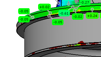

[Lu...] Posted October 7, 2024 Share Posted October 7, 2024 Is there a way to hide the labels if the are behind the inspection model? Zeiss inspect keeps showing them, so you cannot see if it belongs to the front or to the back some where: Here is what i mean: You see one 0.05 measurement (next to the 0.02 value) in the above image does not belong to the rim (see image below). But there is no way to distinguish it, when it stays on. Link to comment Share on other sites More sharing options...
[Ch...] Posted October 8, 2024 Share Posted October 8, 2024 (edited) This functionality should help you: View-> Label -> Hide Automatically Note: Visibility will not adapt during rotation, but after you have finished rotation. If you like to have further information about label visibility, please have an look into the techguide: https://techguide.zeiss.com/en/zeiss-inspect-2023/article/cmd_cad_show_label.html Edited October 8, 2024 Link to comment Share on other sites More sharing options...
[No...] Posted October 10, 2024 Share Posted October 10, 2024 (edited) However, if a label is at the side or very close to the edge of the part in the current view, it will still be displayed although you can't really see the spot it's pointing at. This could be improved if the software would support an additional angle parameter specifying the maximum allowed normal angle of a label's surface point. Labels with a greater angle would become hidden. Edited October 10, 2024 Link to comment Share on other sites More sharing options...
[Ax...] Posted October 14, 2024 Share Posted October 14, 2024 Did you already checked this feature? The smaller the value, the smaller the dots are and the more quickly they are hidden and not displayed. Link to comment Share on other sites More sharing options...
[Lu...] Posted October 31, 2024 Author Share Posted October 31, 2024 Thanks guys, i checked this option and it works as expected. Link to comment Share on other sites More sharing options...
