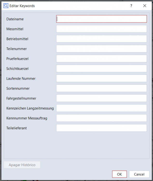

[Ed...] Posted Thursday at 08:02 PM Share Posted Thursday at 08:02 PM (edited) Hello, When exporting DMIS data in Zeiss Inspect 2023 how could I change the language of Keywords' Label? File -> Export -> Inspection -> DMIS... Edited Thursday at 08:03 PM Link to comment Share on other sites More sharing options...
[Da...] Posted Friday at 07:07 AM Share Posted Friday at 07:07 AM Hello Eduardo, the keywords are defined in the corresponding export format. You can change them by exporting the format and importing the edited format again. Or use the Add-on Editor (currently you have to restart the SW after editing the format in the Add-on Editor). Search for "needed_keywords_desc". Here the description of the shown keywords are defined. Regards Daniel Schrein Link to comment Share on other sites More sharing options...
