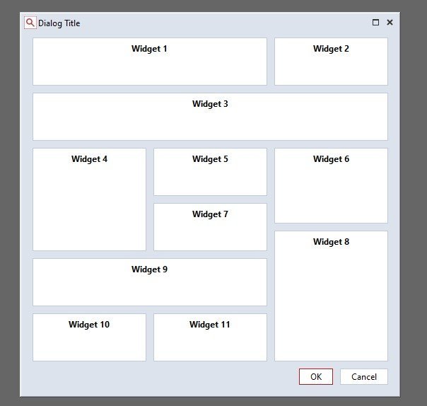

Instructions for Dynamic Dialog Creation using JSON Code
I'm going to share some code for anyone interested in creating your own dialog boxes using JSON code. It was a pain to figure out how to do this  as I had little go off in the forums, but I did find some useful posts on how to build dialog boxes using XML code.
 also pointed me in the right direction with some code that they shared.
I hope this is useful for others!

Some things to know (I don't know that these statements are true for certain, however they seem to hold true for the testing I've done)
* The GUI builder does not allow for subsequent rows and columns to have any gaps between widgets. That is to say if you have a widget in position (x,y) = (0,0), your next widget cannot be located any greater than (x,y) = (1, 1). If you try to place it any further away, then bad things may happen!
1) Your first row of widgets will determine the number of columns that each subsequent row should account for.
        - The example code I have below has code for how a column separator can be inserted. It can be found in the 'buildwidgetList' method.
1) For any given row of widgets, you begin the top left corner and work your way to the right. Remember that you should also be accounting for columns as you work left-to-right (and you may have to even enter empty column separators. My continuous text widget example code demonstrates how/where you can use column separators).
2) For any widget(s) you wish to add, first determine the columns it will span.
        - If you wish to add just one widget for that given row, simply add the one widget. The next widget or widget(s) will be in the next row down.
        - If you wish to add multiple widgets to the same row, you need to build a list of the widgets that belong in that row. The next widget or widget(s) will be in the next row down.

Note: You can double-click anywhere in the code below to open the GUI editor and see the intended layout of the widget locations
To understand how the row and column numbers affect widget placement:
1) Re-arrange my widgets (or make a layout of your own). I recommend using continuous text widgets like I did and naming them in a sequential order. When you resize the window, the contininuous widgets will resize accordingly and make for a good visual queue.
2) Next, review the code below and pay attention to the order the widgets were written out.
3) By looking at the placement of square [] and sguigly {} brackets, you can ascertain how column and row numbering will influence your widget loccations.
