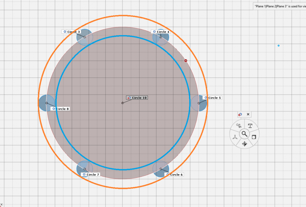

[Ro...] Posted September 21, 2021 Share Posted September 21, 2021 Hi, Can you please let me know the sequence for creating the minimum and maximum diameter of a circle(in this case it took circle 10- from the center of the circles) created from multiple circles? (blue and orange circle) Thank you! Link to comment https://qualityforum.zeiss.com/topic/438-how-to-create-the-min-and-max-diameter-of-a-circle-created-from-multiple-circles/ Share on other sites More sharing options...
[Jö...] Posted September 22, 2021 Share Posted September 22, 2021 I think you want to create the largest and smallest pitch circle diameter? I do not know if there is a integrated solution, but here is my method. From each circle you can construct the center as a point. Construction -> Point -> Point Recall these points as point selection and then create two circles using Min and Max methods. Then retrieve the diameter for each pitch circle. Regards Jörg Link to comment https://qualityforum.zeiss.com/topic/438-how-to-create-the-min-and-max-diameter-of-a-circle-created-from-multiple-circles/#findComment-1306 Share on other sites More sharing options...

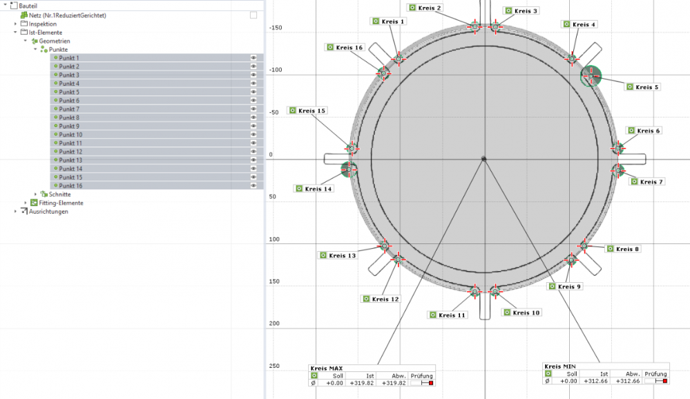

[Ju...] Posted July 26, 2023 Share Posted July 26, 2023 Please sign in to view this username. Hallo, ich habe es wie oben beschrieben versucht nach zu konstruieren aber ich komme nicht weiter. Von was soll man zwei Kreise erstellen und dann die Min Max Methode verwenden? Könnten Sie das vielleicht nochmal bildlich darstellen oder gibt es mitlerweile noch andere Möglichkeiten den min max Kreis auszuwerten? Gruß Julian Link to comment https://qualityforum.zeiss.com/topic/438-how-to-create-the-min-and-max-diameter-of-a-circle-created-from-multiple-circles/#findComment-8336 Share on other sites More sharing options...
[Mi...] Posted July 26, 2023 Share Posted July 26, 2023 Hallo Julian, Du könntest z.B. so wie im angehängten Video vorgehen, wenn Du an Umkreis und Inkreis aller Punkte interessiert bist, aus denen die Einzelkreise gebildet wurden. Viele Grüße, Michael circles.mp4 Link to comment https://qualityforum.zeiss.com/topic/438-how-to-create-the-min-and-max-diameter-of-a-circle-created-from-multiple-circles/#findComment-8340 Share on other sites More sharing options...
