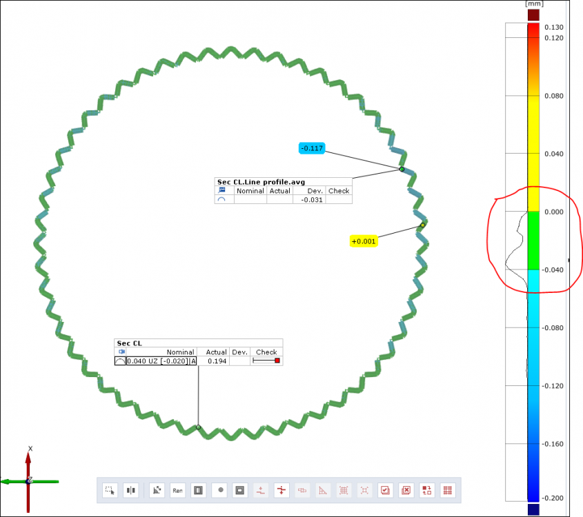

[Jo...] Posted October 29, 2024 Share Posted October 29, 2024 Hello everyone, I am evaluate a profile line from a point cloud, and as you can see I have a low amount of points out of tolerance. I didn't find any way to evaluate a line profile using only 2 or 3 sigma points (like we can do with a lot of geometries constructed by fitting). So, my question is if there are some way to check the percentage of points that are in tolerance (from 0 to -0.04)? Thanks Link to comment Share on other sites More sharing options...

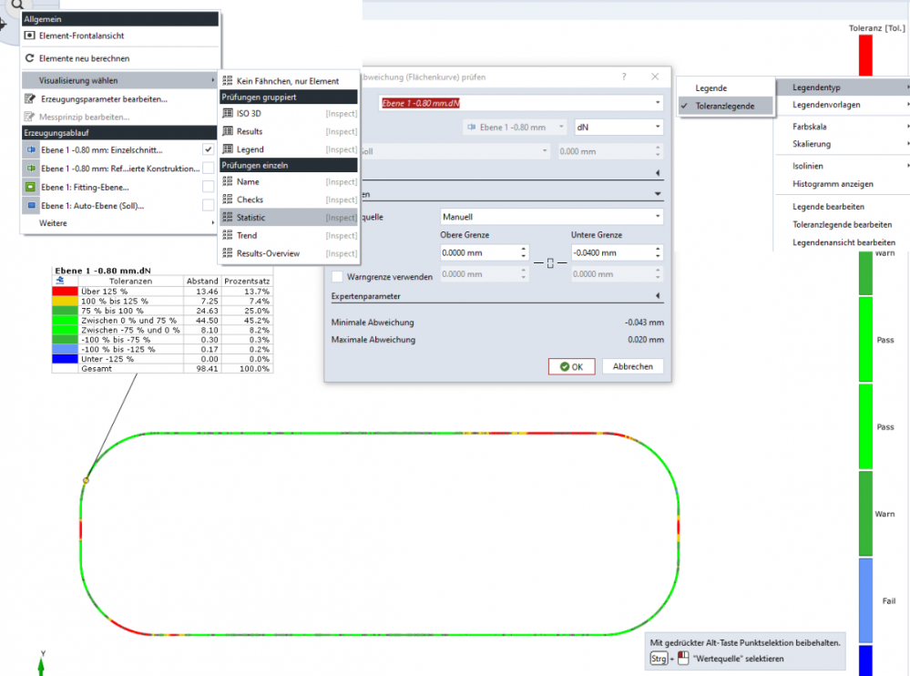

[Mi...] Posted November 6, 2024 Share Posted November 6, 2024 maybe this is what you are looking for? Link to comment Share on other sites More sharing options...
[Jo...] Posted November 8, 2024 Author Share Posted November 8, 2024 Please sign in to view this username. Thank you! It is what i'm looking. Link to comment Share on other sites More sharing options...

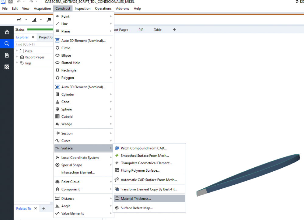

[Mi...] Posted January 16, 2025 Share Posted January 16, 2025 Hi mates Please sign in to view this username. and Please sign in to view this username. , Very useful! Does it work for thickness measurement? This is how i have programmed the thickness measurement: Thank you in advance, Mikel Link to comment Share on other sites More sharing options...
[Mi...] Posted January 16, 2025 Share Posted January 16, 2025 Hi Mikel, yes, it does work for thickness aswell. Make sure you've set the tolerances for thickness. Link to comment Share on other sites More sharing options...
[Mi...] Posted February 24, 2025 Share Posted February 24, 2025 Hi Michael, I have been trying to set the tolerances for thickness, but i don't know how to do it. Could you help me, pleae? Thanks Link to comment Share on other sites More sharing options...
[Mi...] Posted February 24, 2025 Share Posted February 24, 2025 I have achieved it!! Link to comment Share on other sites More sharing options...
