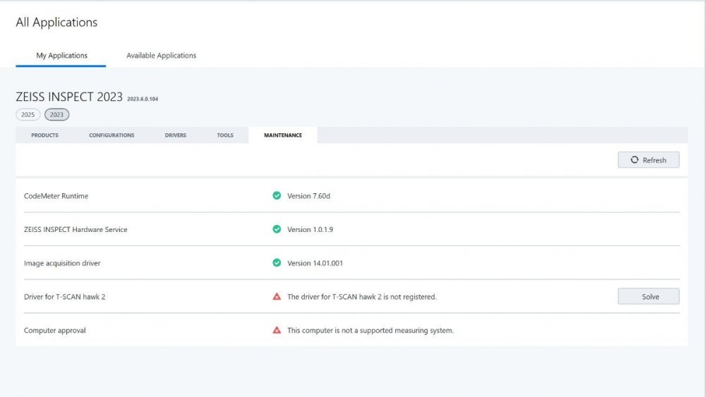

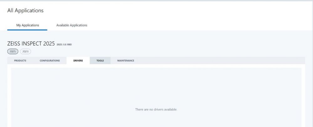

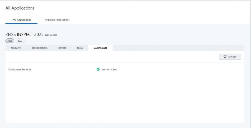

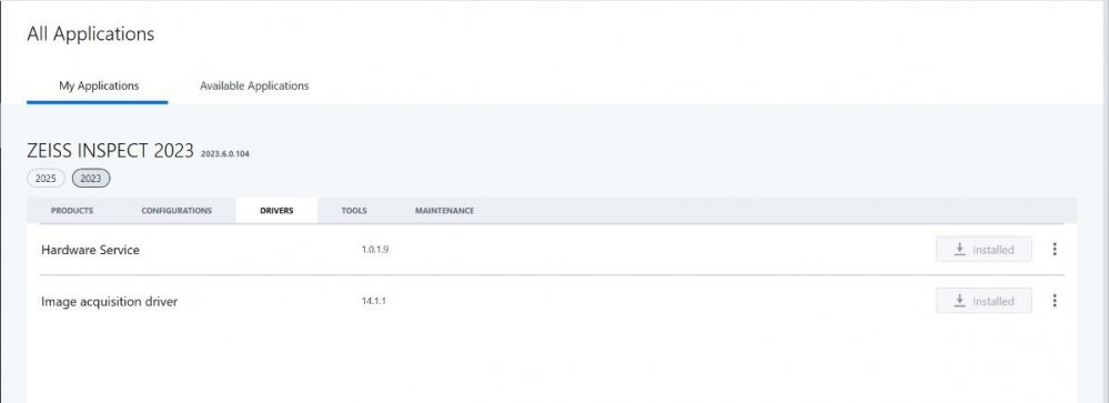

Morning All,
i have updated to the recent major release (2025), however the new software is not picking up the t scan hawk 2,
it is still fully functioning on the 2023 version, i have updated the 2 drivers also
i am not sure what the "driver for t scan hawk 2" is but the scanner works without it being registered, if i try to solve the issue it does not work
please see attached for reference
