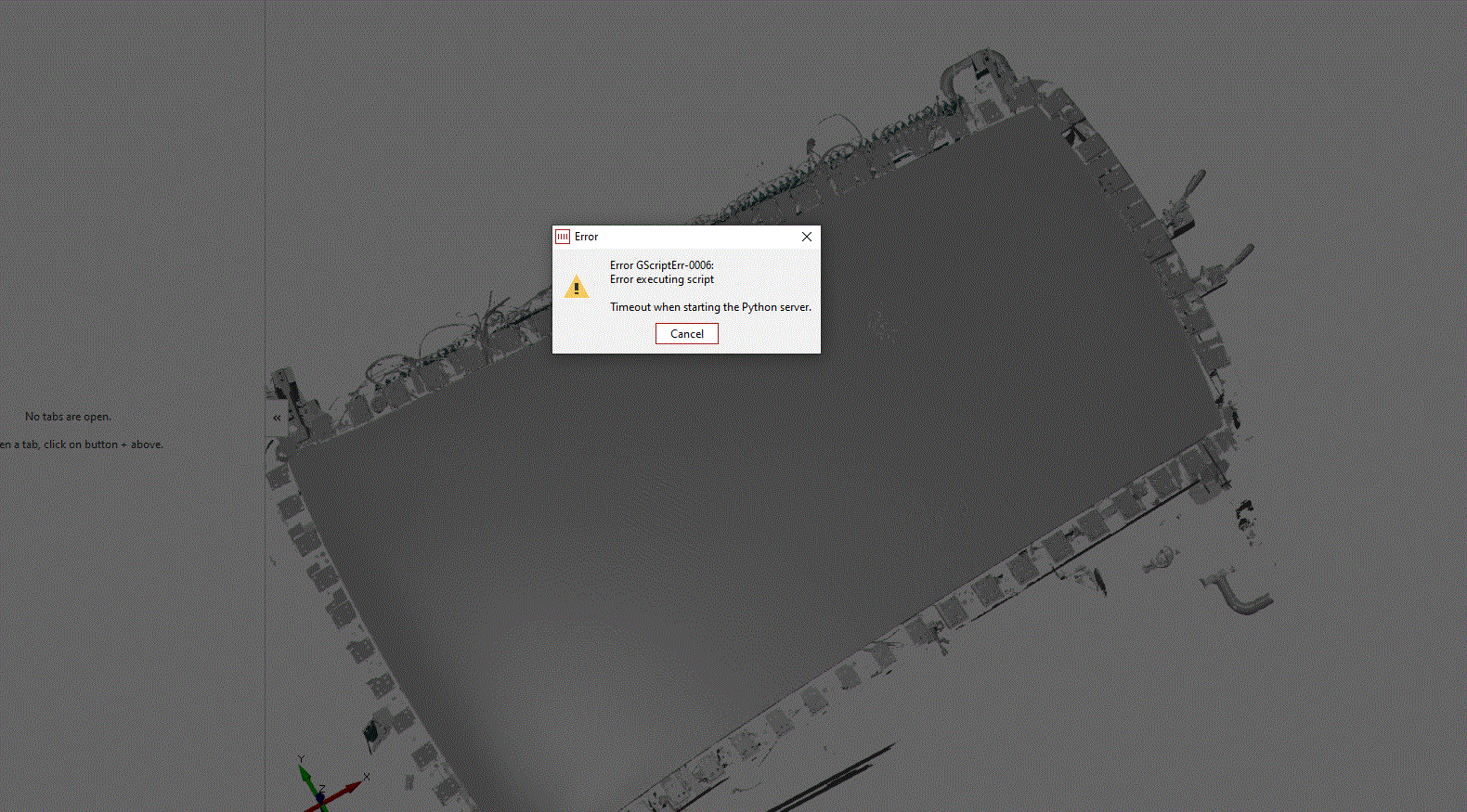

[Ad...] Posted September 22, 2021 Share Posted September 22, 2021 Hello community, Please, I need your support to resolve this issue I would like to start a recorded script but I got a message error "Timeout when starting the python serve" thanks in advance Link to comment https://qualityforum.zeiss.com/topic/444-startin-the-python-server/ Share on other sites More sharing options...
[Fr...] Posted September 29, 2021 Share Posted September 29, 2021 Ok, this is strange. When a script is started, a python process will be launched. If this process does not reply within 5s (constant value), this error will be thrown. Is your system under heavy load ? Does this happen just with that single script or does any other script behave the same way, even if empty ? The python interpreter is located in c:\Program Files\GOM\<version>\python\python.exe. Can you start it right from the explorer/from a command prompt and does it work when doing so ? Link to comment https://qualityforum.zeiss.com/topic/444-startin-the-python-server/#findComment-1333 Share on other sites More sharing options...
