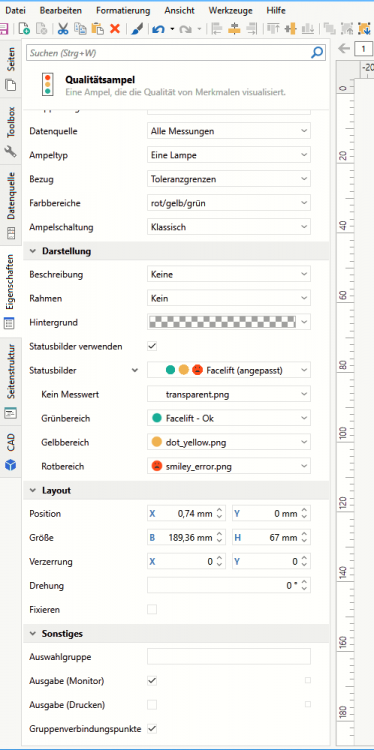

[Ya...] Posted November 13, 2024 Share Posted November 13, 2024 (edited) Hello, maybe something like this? Just copy the little traffic light make it BIG inside the header and make the gray indicator as transparent.png. With a right Mouse click you can set it into the background. Deselect inside the settings tab on the left (Output) Printer. So it wont show up on the saved PDF.. Kind regards YM. Edited November 13, 2024 Link to comment https://qualityforum.zeiss.com/topic/4466-don%E2%80%99t-create-pdf-if-inspection-fails/#findComment-121088 Share on other sites More sharing options...
[Ma...] Posted November 13, 2024 Share Posted November 13, 2024 You could implement N.i.O. into protocol path then delete N.i.O. ones later. inspectionToleranceState() It returns "inTolerance" or "outOfTolerance" Link to comment https://qualityforum.zeiss.com/topic/4466-don%E2%80%99t-create-pdf-if-inspection-fails/#findComment-121092 Share on other sites More sharing options...
