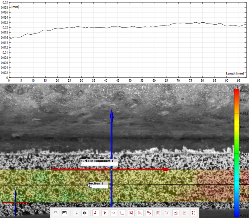

Hallo everyone,
thank you for your time. I'm about to export the diagramm, here I use the function of inspection sections ''Section in viewing direction''. The vertical coordinate is the z-displacement, the horizontal coordinate should be self-defined x-coordinate, but it turns out to be the length of this section 1, as shown in the figure below. How can I change the horizontal coordinate from length to x-coordinate?
 If you have any idea, please write it. Thank u very much!
Best Regards
Zhou
Hi Zhou,
you can't change the X-axis of the diagram with sections.
I would recommend to select the inspection of your section and export it as CSV.
In the CSV you have the coordinate of each point on the section with the displacement among other things.
Greetings, Ivan
