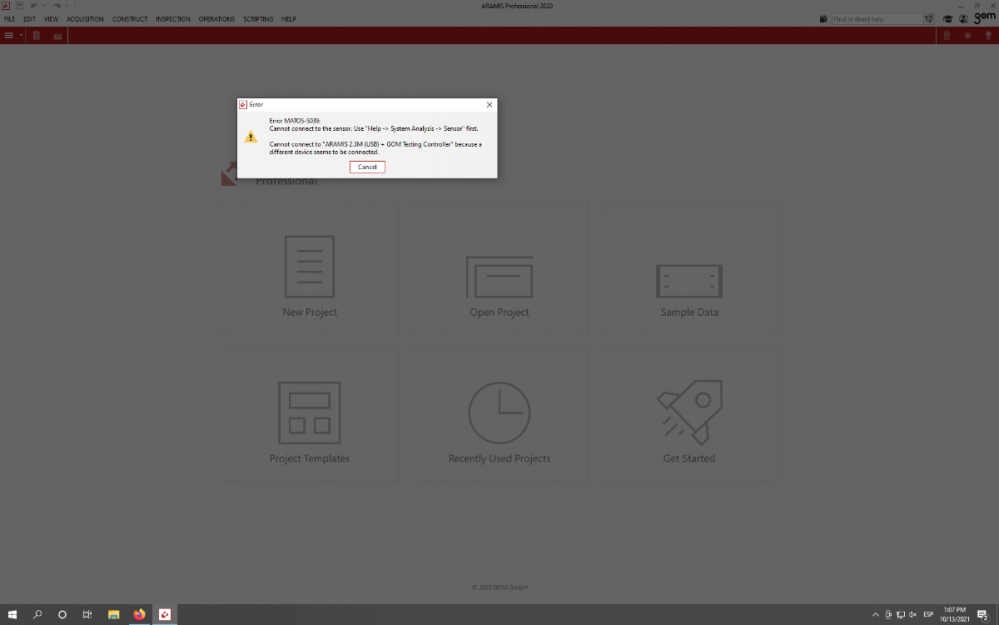

Error MATOS-S039
Hi Eva,
for those possible hardware problems you don't need support contract.
Did you followed the step which is mentioned in the error message? So did you do sensor analysis?
Greetings, Ivan
  • 1 year later...
Id associate this error primarliy with cabling / connection.  For instance only comms with one camera such that it thinks a different sensor type is connected.   Id start by reseating things.
I think this quickly gets beyond where a forum can help you.  Id do the following
  • Make sure you did ' check, clean , detect' in that order
  • Contact hardware support with GOMsic
There is a tool/ application called GeV which allows you to see what cameras are seen , tthis is helpful in these cases ,but id leave it to the support geys to talk that with you.
