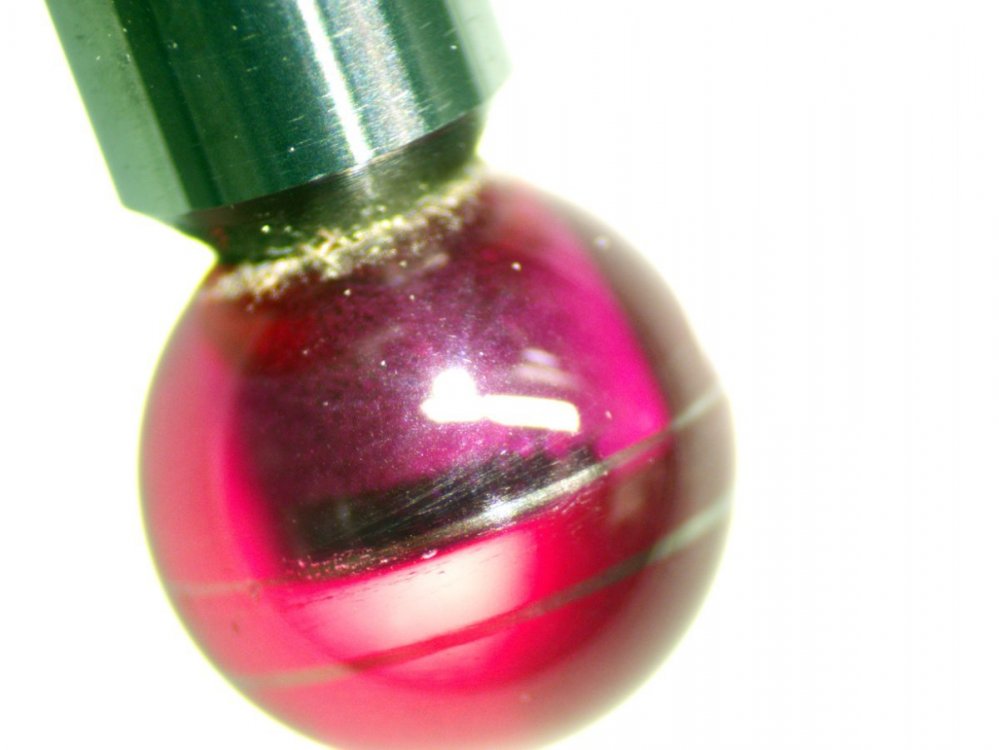

[Lu...] Posted March 24, 2025 Share Posted March 24, 2025 Hello, what are your all's thoughts on this ruby? I saw how this ruby has 2 rings on it and i wanted to know if this would warrant replacing it. Im new to the cmm world so i am unaware if these rings would indicate any loss in accuracy or if they are pretty common. For reference the ruby is 5mm in diameter. Thank you all very much! Link to comment Share on other sites More sharing options...
[Ja...] Posted March 24, 2025 Share Posted March 24, 2025 (edited) Please sign in to view this quote. Luke, Looking at that ruby I would err on the side of replacing it but you can try gently wiping it first with a clean microcloth and some isopropyl alcohol to see if those "rings" clean off first. My guess is those "rings" are forming from scan paths you are consistently using and beginning to wear into the ruby so they won't simply wipe away. The probe may still be qualifying fine and you may not be seeing loss of accuracy yet however like others in this thread have stated it is usually safest and easiest to swap it out for a new probe when there is any doubt. Edited March 24, 2025 Link to comment Share on other sites More sharing options...
[Ri...] Posted March 25, 2025 Share Posted March 25, 2025 Please sign in to view this quote. That would clean off quite easily using the method I posted earlier about electric pencil eraser and Mylar inserts. Link to comment Share on other sites More sharing options...
[Ma...] Posted March 25, 2025 Share Posted March 25, 2025 It looks like you have been scanning aluminum. I think it is material built up on the stylus rather than wear. If this is the case, it may be prevented by using a different material than aluminum-oxide (ruby) such as silicon nitride for scanning aluminum. Link to comment Share on other sites More sharing options...
