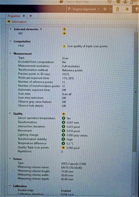

[Ji...] Posted November 5, 2021 Share Posted November 5, 2021 Every scan which we perform now shows the Quality triple scan points between 1,7 and 2,5 px. Could you advise what to check to fix it? Thanks for any advice PS. Beginner only. Jitka Jekova Link to comment https://qualityforum.zeiss.com/topic/524-quality-triple-scan-points-22px/ Share on other sites More sharing options...

[Ad...] Posted November 9, 2022 Share Posted November 9, 2022 I recently started getting a lot of errors due to triple scan points. Jitka, did you ever resolve your issues? I've adjusted aperture, focus, and recalibrated, but it hasn't helped. Link to comment https://qualityforum.zeiss.com/topic/524-quality-triple-scan-points-22px/#findComment-5178 Share on other sites More sharing options...
[Du...] Posted December 20, 2022 Share Posted December 20, 2022 Hello All, just received the same quality issue. I tried everything (calibration, projector and cameras re-mounting etc.) Do we have a way how to fix it? Thank you! Link to comment https://qualityforum.zeiss.com/topic/524-quality-triple-scan-points-22px/#findComment-5533 Share on other sites More sharing options...

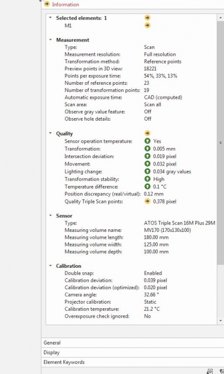

[Du...] Posted December 22, 2022 Share Posted December 22, 2022 Problem solved. Our fixture where the part was located contained a black shiny hub, which was causing the issue (part was sitting on the hub during the scanning and i needed to scan the part from the top and bottom in one Measuring Series - no scanning from the other side and aligning two sets of measuring series). Scanner cameras could not apply Triple Scan principle due to different reflections in particular shots (resulting in pixel values over 0.3 which seems to be the baseline for Triple Scan principle application). Seems like it is wise to avoid using any shiny fixtures, even when scanning just a small area of those. Link to comment https://qualityforum.zeiss.com/topic/524-quality-triple-scan-points-22px/#findComment-5567 Share on other sites More sharing options...
[Pe...] Posted January 20, 2023 Share Posted January 20, 2023 We had something similar. Measuring a small object on the turn table , after recalculation, all scans yellow. Only stickers around the small part. After putting more stickers all over the table, it went away. Link to comment https://qualityforum.zeiss.com/topic/524-quality-triple-scan-points-22px/#findComment-6606 Share on other sites More sharing options...
