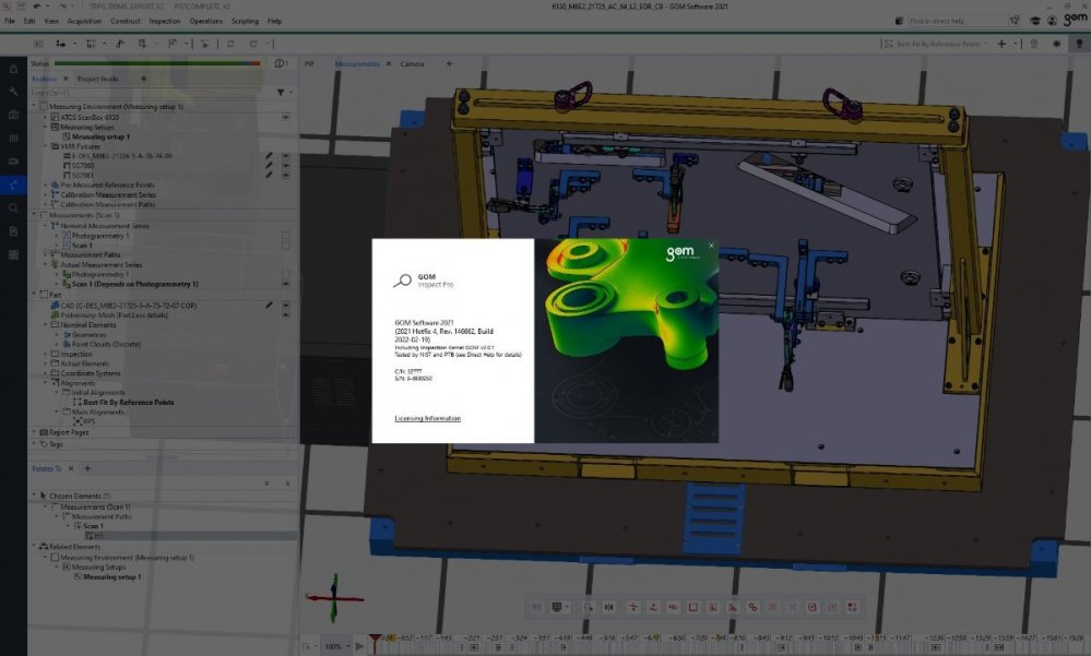

I have had the chance to run a full project using...
Inspect Pro 2021 Hotfix 4.

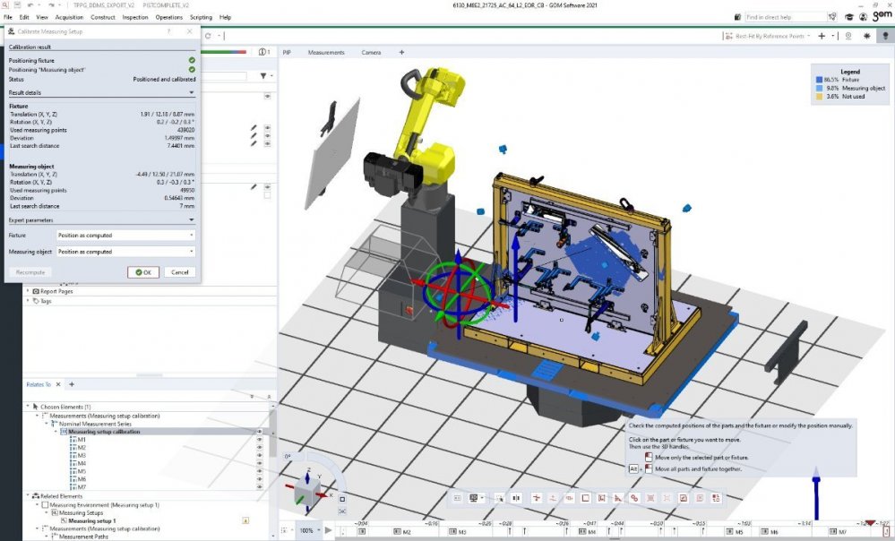

I calibrated my Measurement Setup getting...
6130_M8E2_21725_Measurement_Setup_Calibration_Default.thumb.jpg.baee6b3c98310296bcf75597f8231ebe.jpg

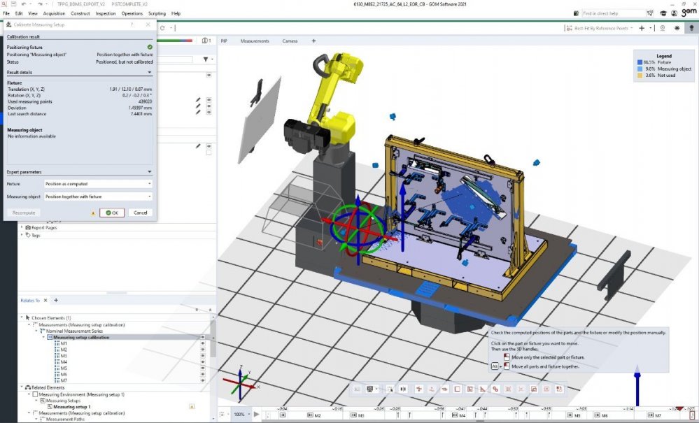

But obviously changed this because our fixture has the alignment features. So I moved the panel with the fixture like this...
6130_M8E2_21725_Measurement_Setup_Calibration_Panel_With_Fixture.thumb.jpg.c88e9e908f67e35b5741dc218540b160.jpg

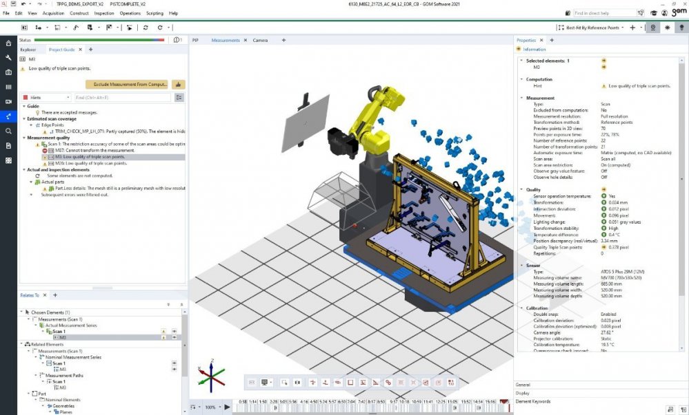

Getting low quality scan points at scan M3, but position discrepancy was less than 10mm as suggested...
6130_M8E2_21725_M3_Position_Discrepancy.thumb.jpg.aa9a9c0ffe39e14188519e8e23423b3b.jpg

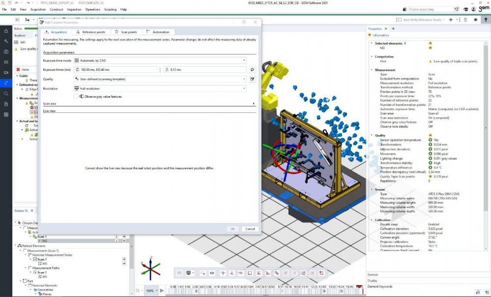

So checked exposures (Automatic by CAD was used when teaching). Here is what was taught....

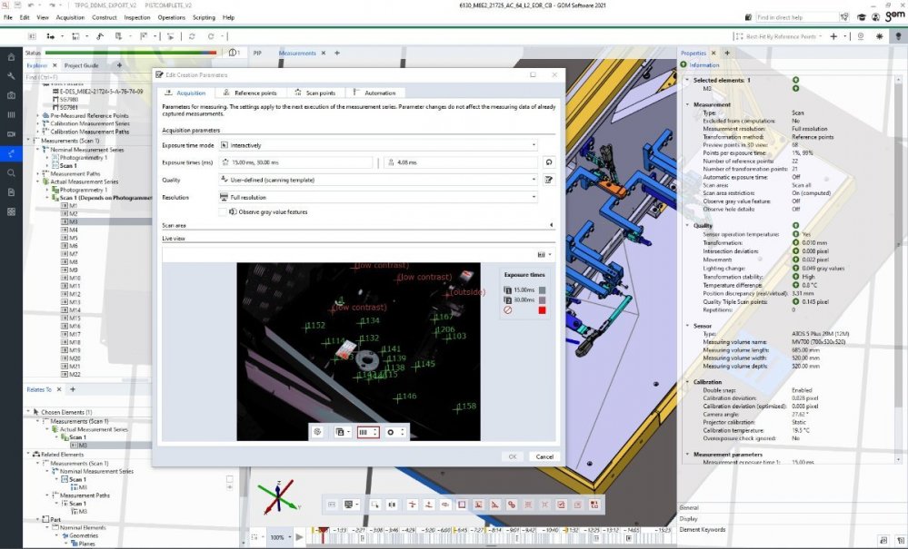

So I switched to interactive exposures and set appropriately and scan data was satisfactory....
SO MY QUESTION STILL STANDS.
HOW DOES AUTOMATIC EXPOSURE BY CAD PRODUCE SUCH BAD RESULTS?
