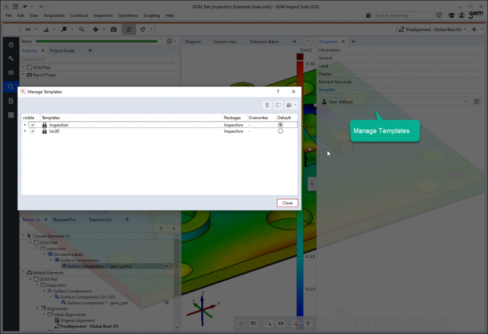

[Má...] Posted November 23, 2021 Share Posted November 23, 2021 Hello, Some label visibility settings got chage in some of our project. You can see in the attached video that new dev labels are not visible when it get placed just if we change the visibility. How/what can we chage that the labels can be visible during we place those. BR, Máté Dev_label problem.mp4 Link to comment Share on other sites More sharing options...
[Na...] Posted November 23, 2021 Share Posted November 23, 2021 Hello Máté, this seems to be an older project opened in 2020 or 2021, right? Please try to select the deviation labels and set the standard for new elements to "Inspection". You find this on the bottom right of the properties tab in the 2021 and under "manage templates" in the 2020: Regards, Nanno Link to comment Share on other sites More sharing options...

[Da...] Posted May 30, 2023 Share Posted May 30, 2023 Hi I'm in version 2022 i usually did this way View > screan setup > ui configurations and choose inspection because it changed from time to time like by itself or i do not know how. Now its like i can choose "Inspection" but when i go back in this menu its not highlighted and the labels are not shown when creating new elements. I can create my template but and it can be choosen as it gets highlighted when selected. Just do not know how to edit it. How can i solve it ? Link to comment Share on other sites More sharing options...
