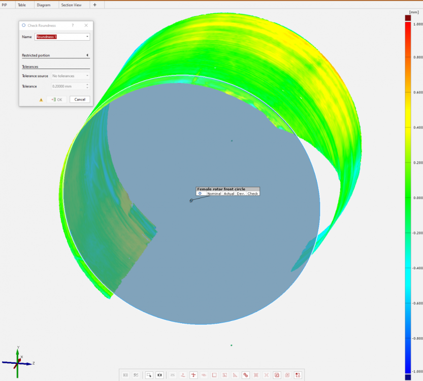

[Je...] Posted December 9, 2021 Share Posted December 9, 2021 (edited) I applied a GD&T roundness check to my cone. This was succesfully done, see figure in attachment. However, When trying to do the same for a circle constructed from this cone, the software mentions "this gd&t tolerance cannot be applied to all selected elements." I create the circle using 'Construct Intersection Cylinder/Cone'. It is not clear to me when GD&T roundness can be applied to a circle and when it cannot. Edited December 9, 2021 (updated figure) Link to comment Share on other sites More sharing options...
[Ch...] Posted December 10, 2021 Share Posted December 10, 2021 This creation command creates a purely geometric circle, which cannot be checked with GD&T tolerances (and is perfectly round by definition). You need a circle that is defined on a "real" section of the mesh of the cone with a plane: - define a section plane, e.g. from the cone axis and a point - Restore the selection of the cone (right click the cone and choose "Restore Point Selection") -Call command Construct->Section->Single Section.. and choose the defined section plane -Create a fitting circle on the resulting section and check it for roundness (If you start in the nominal, you will have to apply the appropriate measuring principles.) Link to comment Share on other sites More sharing options...
[Je...] Posted December 10, 2021 Author Share Posted December 10, 2021 Hi Christian, Thank you for your reply. That worked indeed. However, you mentioned that the creation command ' Construct Intersection Cylinder/Cone' creates a purely 'geometric circle'. But when later on actual data is applied, I assumed the constructed actual circle should be allowed a circularity check. Anyway, I was able to circumvent that problem following your steps. Much appreciated! Kind regards Jeroen Link to comment Share on other sites More sharing options...
