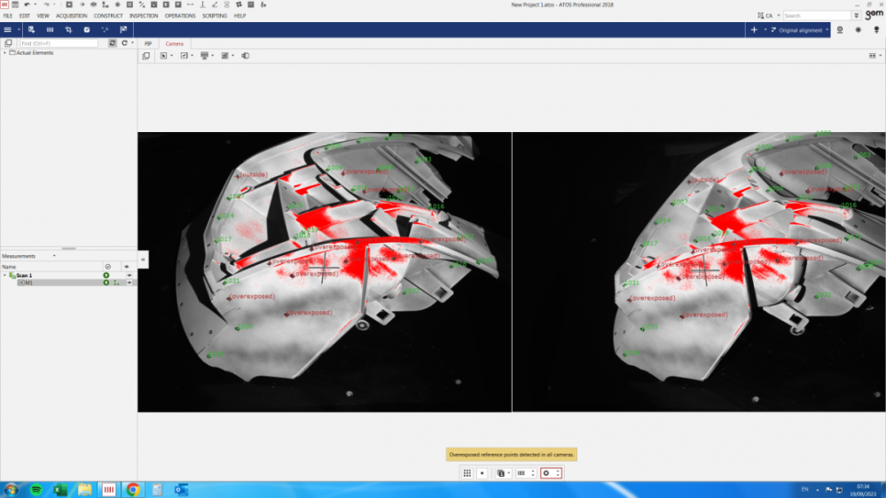

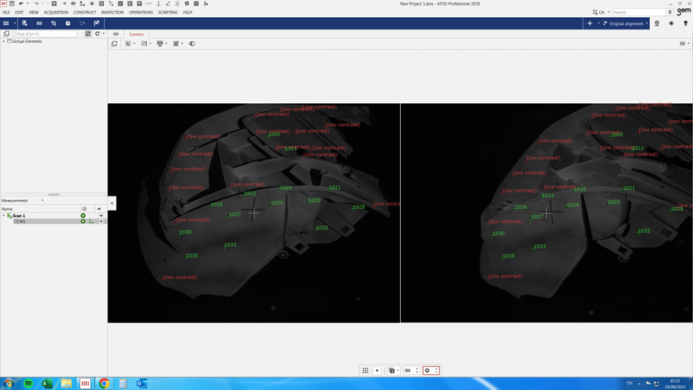

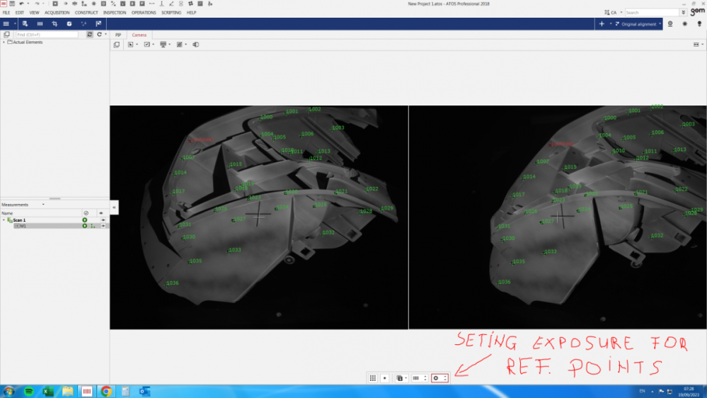

[Zv...] Posted September 19, 2023 Share Posted September 19, 2023 I hope this captures will help you understand what do you have to do about exposure on reference points (markers we are calling them) Link to comment Share on other sites More sharing options...
