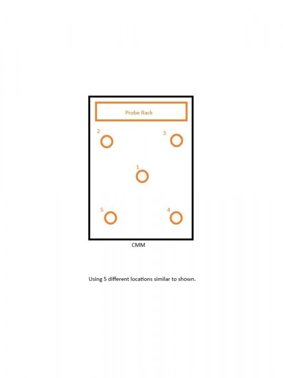

[Si...] Posted March 26, 2025 Share Posted March 26, 2025 Okay, I made a program that measure the Ø30 ref. sphere. Datum is made with the masterprobe. I then compare the other stylus systems to the masterprobe. If you then get a difference in XYZ and diameter. What do you do? do you chance the geometry of the stylus? Link to comment https://qualityforum.zeiss.com/topic/6388-qualification-vs-verification/#findComment-129063 Share on other sites More sharing options...

[Ri...] Posted March 26, 2025 Share Posted March 26, 2025 (edited) Please sign in to view this quote. I have been doing something similar since 2003. I base it on the standard 5 articulations. 1. Place the Reference sphere in the middle of the CMM. 2. Run CMM program that uses the 5 standard articulations. 3. I report Diameter, Form, and True Position (spherical). 4. Diameters are set to ±.0001" 5. Form to max .0001" 6. True position is .0003". 7. Once a month run the program at one of the 5 different locations (See image: Locations) 8. At the 6th month, place the reference sphere on a riser (I use an 6-inch riser). 9. Run the program once a month thru the 5 locations using the riser. 10. Go back to #1, wash, rinse, repeat. 11. Add data to an MSA for the duration of the current calibration. This not only can help detect an issue, it also checks a good range of the working volume. This has never failed to find an issue if there is one, it was about 8 months ago when this plan found an issue with a 1 1/2-year-old Contura 2014, it was the XTR sensor. The same program is edited for our XXT sensor now. You can also perform this same test with raw data, no filters, no outliers turned on. I make charts of refined measurements and Raw measurements, if I over lay these and they do not appear to be very similar, you can start to look at why? Edited March 26, 2025 Link to comment https://qualityforum.zeiss.com/topic/6388-qualification-vs-verification/#findComment-129119 Share on other sites More sharing options...
