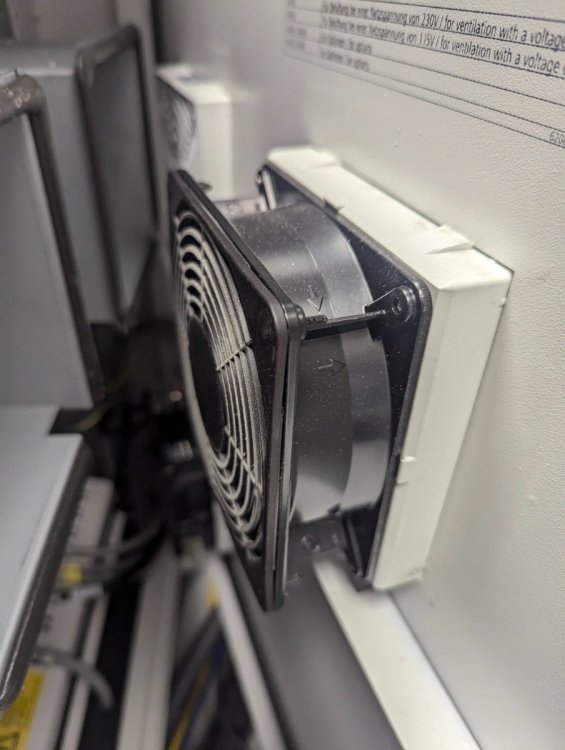

[Ro...] Posted January 10, 2024 Share Posted January 10, 2024 CNC disabled Controller Temp over 66.5º (150º f) We are now getting this err on our machine a couple times a day, we tried to open the Calypso "app" for controler temp (mini controller) but connection was refused. does anyone know how to monitor the temp of the controller computer? I currently have a fan on the control box, and we have canned air on order to clean out what we can get to Link to comment https://qualityforum.zeiss.com/topic/6426-controller-temp-error/ Share on other sites More sharing options...

[Ke...] Posted January 10, 2024 Share Posted January 10, 2024 Sounds like either a C98 or, more likely, a C99. There are usually a couple of vents, which may or may not have fans, on the rear of the controller. These are easy to remove, and probably have filters behind them. I would pull the vent covers off, and check the filters. These are commonly forgotten, and will fill with dirt and block ventilation over time causing controllers to overheat. If this isnt the case you will almost certainly need to contact the Hardware department (if your controller has gotten that hot I would contact them anyways, for a check to make sure nothing got cooked). Link to comment https://qualityforum.zeiss.com/topic/6426-controller-temp-error/#findComment-25296 Share on other sites More sharing options...

[Ro...] Posted January 19, 2024 Author Share Posted January 19, 2024 Please sign in to view this quote. Final Solution....... I looked behind a panel wall and found 3 filters clogged like crazy. I didn't have any filter material this thin (less than 1/4 inch) so i went with much thicker material smushed into the same spot. Its now been a week and no more problems, the filters are flowing good enough.hjbghjgvkjhj.jpgliugyjugtufrtydt.jpgbnvghcgfdrhgjfcgf.jpgjhvjhvjvghkcvh.jpg Link to comment https://qualityforum.zeiss.com/topic/6426-controller-temp-error/#findComment-25302 Share on other sites More sharing options...

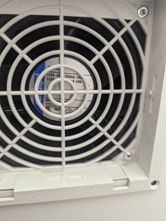

[Ch...] Posted December 20, 2024 Share Posted December 20, 2024 (edited) Does anyone want to explain why Zeiss is quoting me $23,000 for this fan. I normally don't mind the Zeiss tax; But these things are about $20 dollars online. I might even splurge and get the $40 ultra-premium oneemium one. Edited December 20, 2024 Link to comment https://qualityforum.zeiss.com/topic/6426-controller-temp-error/#findComment-122984 Share on other sites More sharing options...
[Mi...] Posted December 20, 2024 Share Posted December 20, 2024 (edited) That's insane, there has to be a mistake there. For anybody who doesn't know... fans are like bearings, it's all standardized. Look up the specs, voltage, RPM, CFM, match them ( don't forget to compare the connector) and buy from whoever you like.... 23k for a standard fan is insane if that's all it is. Also, for anybody curious... here's some PCM code to play with to grab the controller temps... addToFile("C:\data\cmm\stf\ControllerInfo.txt",cmmInquire("sfmt(#cpuTemperature)"),",",cmmInquire("sfmt(#cpuFanSpeed)"),",",time(),",",dateInNumbers()) Edited December 20, 2024 Link to comment https://qualityforum.zeiss.com/topic/6426-controller-temp-error/#findComment-122986 Share on other sites More sharing options...
[Ch...] Posted December 20, 2024 Share Posted December 20, 2024 That's my plan. Link to comment https://qualityforum.zeiss.com/topic/6426-controller-temp-error/#findComment-122996 Share on other sites More sharing options...
[Ma...] Posted December 22, 2024 Share Posted December 22, 2024 Please sign in to view this quote. A new controller must come with that fan Link to comment https://qualityforum.zeiss.com/topic/6426-controller-temp-error/#findComment-123014 Share on other sites More sharing options...
