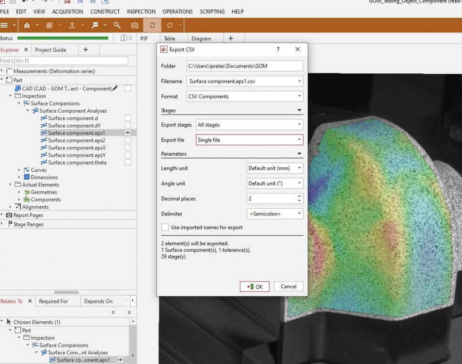

[Gu...] Posted January 28, 2021 Share Posted January 28, 2021 Hi everyone, When I "check displacement" in a given axis, such displacement is displayed as a color map on the original surface. I am interested in visualizing the displacement values in 3D, either as a point cloud or a surface, of all the surface points. Is it possible to visualize it and to export it? We can visualize it as a curve: constructing surface curve --> checking the displacement in Z (for instance) in that curve --> exporting the diagram data in *csv format. I would like to do this but for all the surface points, to a *csv or to any 3D format. Link to comment Share on other sites More sharing options...
[Iv...] Posted February 22, 2021 Share Posted February 22, 2021 Hi Guillermo, you can basically export any inspection as a CSV file. Just select the inspections you would like to export within the explorer on the left side. Then go to the export area: File → Export → Stage data → CSV Choose the CSV Components. The CSV export will contain the 3 coordinates of each facet point of the surface and the related value of the inspection. You can add further inspections, too. They will be added to the list as an additional column. I hope this what you wanted. Greetings, Ivan Link to comment Share on other sites More sharing options...
