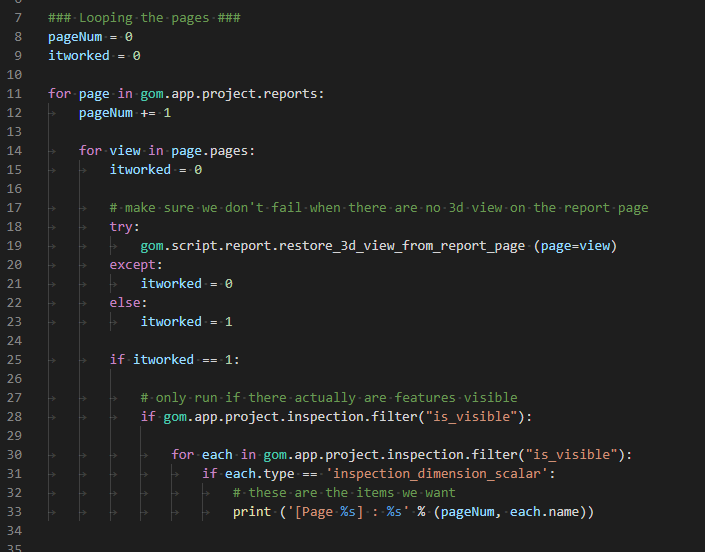

[Fr...] Posted February 10, 2022 Share Posted February 10, 2022 Hi. I am trying to make a list of features that are on a report sheet (the end goal is to produce an output file to use to sync information between GOM and another system, and there is no existing export format that cover my needs). My problem is that there are always more points caught by the filter "is_visible" than there are points on the report sheet, and some of the points that I get when looping "is_visible" is not even selected on screen when i do a "select all" and is not showing in "relates to" list on screen. In short I am confused ? Here is an example of where I am at the moment: (I'm currently on 2020 HF6) If anyone has a good solution I'm all ears. regards Fredrik Link to comment Share on other sites More sharing options...
[Na...] Posted February 11, 2022 Share Posted February 11, 2022 Hello Fredrik, there is "gom.app.project.reports['report 4'].all_elements_in_report" in the insert dialog in the script editor. What are you missing form existing export templates? Regards Nanno Link to comment Share on other sites More sharing options...
