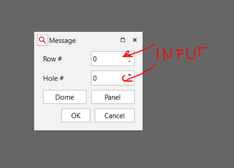

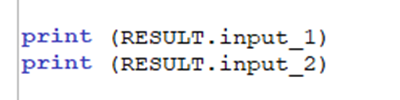

[Du...] Posted February 16, 2022 Share Posted February 16, 2022 Hello GOM users, I was wondering if somebody could help me with understanding of user dialog input features? I know how to operate with the value which is called from User Dialog. below attached is a way how i am using the user input from the User dialog I was wondering if somebody could help me with Button set-up? The idea is, that operator will select Dome or Panel button (it is Toggle Button Type) and i would like to work with this feature. I would like to make a decision IF Dome is selected, certain TXT file is loaded, else it would read a different file. I tried to print the button value (i assume YES/NO or 1 or 0) but it did not work thank you for any help! Regards Dusan Link to comment https://qualityforum.zeiss.com/topic/702-gom-scripting-user-dialog-button/ Share on other sites More sharing options...
[Je...] Posted February 17, 2022 Share Posted February 17, 2022 Hey Dusan, Activities inside the dialog will be noticed inside the dialog event handler. Whenever an action is run inside the dialog the 'widget' represents this action (eg the user is clicking the button). If you then analyse the widget (eg is the widget name equal to the button name) you can take further steps. def dialog_event_handler (widget): try: if widget.name==DIALOG.button.name: print (DIALOG.button.value) except: pass Hope this helps! Gruß, Jens Link to comment https://qualityforum.zeiss.com/topic/702-gom-scripting-user-dialog-button/#findComment-2139 Share on other sites More sharing options...
