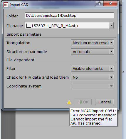

[Ad...] Posted March 26, 2024 Share Posted March 26, 2024 (edited) Hi. Today I encountered a similar problem with Atos Professional V8. Regards Adam Edited March 26, 2024 Link to comment Share on other sites More sharing options...
[Na...] Posted March 27, 2024 Share Posted March 27, 2024 Hello Adam, please use this workaround: ZEISS Quality Tech Guide Link to comment Share on other sites More sharing options...

[Na...] Posted March 27, 2024 Share Posted March 27, 2024 Hello, the workaround from the FAQ will work with the free software 2023. Link to comment Share on other sites More sharing options...
[ni...] Posted March 27, 2024 Share Posted March 27, 2024 bonjour, pour le problème de licence expirée (MCADImport-0051) quand il est impossible d'importer les CAO STP ou IGS, il suffit de reculer l'horloge du computer d' un an ou plus, et il est possible importer les CAO. Link to comment Share on other sites More sharing options...
[Ja...] Posted March 31, 2024 Share Posted March 31, 2024 I think it may help with a bit of explanation as f i recall correctly , there is a time based issue here. Older versions of the software stopped being able to import .stp files due to licencing that is effectively baked into the software. I.e. If you are still trying to use free version from v8.5 i would guess this falls into that situation as this is now very old software . .stp import works no problem in the newer versions of free software , at least from 2019 onwards. I have my reservations about the newer free licencing model from zeiss , but in the end if you download and register the latest version i would expect your problem to go away. Link to comment Share on other sites More sharing options...
