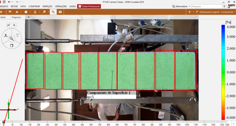

[To...] Posted March 31, 2022 Share Posted March 31, 2022 I would like to split my surface component into several parts so that it is possible to evaluate different parts of my sample without having to create a surface component in each part, as shown in the attached image. It would be possible? If yes, through which steps? Thank you very much. Link to comment https://qualityforum.zeiss.com/topic/785-is-it-possible-to-split-or-section-the-surface-component-into-several-parts/ Share on other sites More sharing options...

[Di...] Posted July 11, 2023 Share Posted July 11, 2023 I have the same issues a few weaks ago and I made the division on my CAD part creating the "surfaces" that I wanted to analyze seperaly Link to comment https://qualityforum.zeiss.com/topic/785-is-it-possible-to-split-or-section-the-surface-component-into-several-parts/#findComment-8225 Share on other sites More sharing options...
