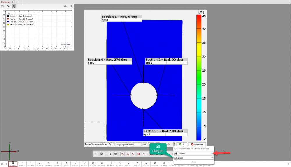

Hello, I am new to GOM Software. Please tell me how to export strain analysis results in each induvidual stage in the form of images.
Hello Farooq,
you could create a report page with the diagram and chose "flipbook" in the creation dialog. This will create a separate page for every stage. Then the report pages can be exported as .png.
