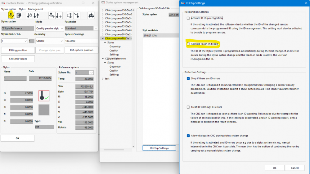

[Ri...] Posted February 10, 2023 Share Posted February 10, 2023 What does this message mean? See attached image, messages in question are in violet. This has recently started happening, using v2019.Teach-in mode.JPG Link to comment Share on other sites More sharing options...
[Mé...] Posted January 9, 2025 Share Posted January 9, 2025 Hello, to solve this problem, you can activate the Teach-in mode from the stylus manager. Link to comment Share on other sites More sharing options...
