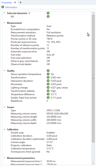

[Vi...] Posted May 4, 2022 Share Posted May 4, 2022 Hello, My goal: To export a table containing the measurement information (objective, temperare, point in 3D etc..). This data is also found in right menu after clicking a scan (see picture). Though no export function is available. My effort: So far I have found no way to export data directly. I started creating a script (see code below). I managed to loop the scans and get some of the data. My question: How can I find a list with all member names? For now I am lucky and find some names. I attempted to search object with: dir(j) or vars(j) but got stuck from there. I thought the easiest is creating numpy table and exporting to CSV (but I think I can do that, did that before). Please forgive me if there are easier ways unknown to me.🙃 Sample Code (partial data is found): import gom all_actual_meshes = [i for i in gom.ElementSelection ({'category': ['key', 'elements', 'explorer_category', 'measurements']})] for i in all_actual_meshes: for j in i.measurements: print(j.name) print(j.type) #print(j.excluded_from_computation)??? print(j.measurement_resolution) print(j.transformation_method) #print(j.preview_points_in_3D_view)??? #print(j.computation)??? print(j.sensor_type) print(j.measuring_volume_name) print(j.measuring_volume_length) print(j.measuring_volume_width) print(j.measuring_volume_depth) print(j.calibration_deviation) print(j.calibration_deviation_optimized) print(j.calibration_camera_angle) print(j.comment) print("") Output: M1 scan full_resolution reference_points ATOS 5 (12M) MV320 (320x240x240) 335.0 260.0 235.0 0.029686492240571464 0.009335919661607923 0.4841352701874103 M2 scan full_resolution reference_points ATOS 5 (12M) MV320 (320x240x240) 335.0 260.0 235.0 0.029686492240571464 0.009335919661607923 0.4841352701874103 Link to comment https://qualityforum.zeiss.com/topic/907-measurement-information-table-automate/ Share on other sites More sharing options...

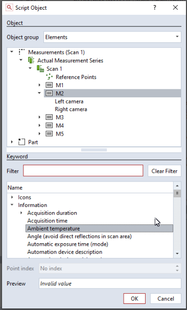

[Vi...] Posted May 5, 2022 Author Share Posted May 5, 2022 Found the solution: 1) Right Click in editor: 2) Select element. 3) Select keyword from list! Link to comment https://qualityforum.zeiss.com/topic/907-measurement-information-table-automate/#findComment-2783 Share on other sites More sharing options...

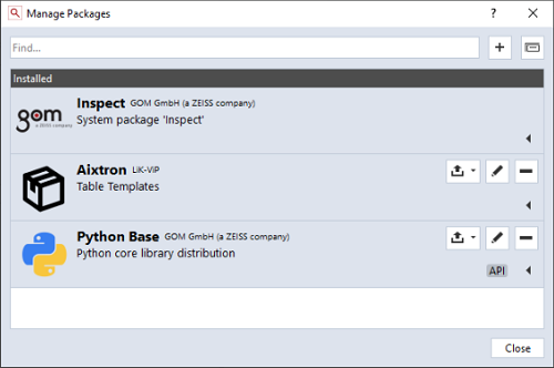

[Vi...] Posted May 5, 2022 Author Share Posted May 5, 2022 (edited) My goal is fulfilled. Below my findings and learning. Some recommendations experiences users is welcome. Learnings: With right mouse button: insert=>element value F2=> the specific element names can be found and inserted. I had problems that numpy and pandas where not available. Installed the package: Python Base (2020) from Zeiss here: https://connect.gom.com/display/GPF/Python+Base Package contains: numpy, pandas, scipy etc... Make a full disk image from GOM atos system (if something goes wrong). Install package by clicking + (plus) button in list below. Learned about packages: It was unclear how to install. First attempted with: scripting=>script choice=>tools=>install python package. But was not able to install the downloaded package. Likely this option is only for Python packages. The Python Base (2020) installed without problems with Gom packages as described above. My code that creates table measurement settings: Needs some tidying up but functional. I am very happy with the possibilities, for a new fresh GOM Atos user (two months). But with data analysis experience Python. import gom import numpy as np import pandas as pd from pathlib import Path #file and stage name file=gom.app.project.name path=gom.app.project.project_file stage=gom.app.project.stage #Messagebox to select path RESULT=gom.script.sys.execute_user_defined_dialog (content='<dialog>' \ ' <title>Save Measurement Setting</title>' \ ' <style></style>' \ ' <control id="OkCancel"/>' \ ' <position></position>' \ ' <embedding></embedding>' \ ' <sizemode></sizemode>' \ ' <size width="271" height="172"/>' \ ' <content columns="1" rows="3">' \ ' <widget column="0" type="label" row="0" rowspan="1" columnspan="1">' \ ' <name>label</name>' \ ' <tooltip></tooltip>' \ ' <text>Export measurement data to:</text>' \ ' <word_wrap>true</word_wrap>' \ ' </widget>' \ ' <widget column="0" type="input::file" row="1" rowspan="1" columnspan="1">' \ ' <name>folder</name>' \ ' <tooltip></tooltip>' \ ' <type>directory</type>' \ ' <title>Choose Folder to export to</title>' \ ' <default>' + path + '</default>' \ ' <limited>false</limited>' \ ' <file_types/>' \ ' <file_types_default></file_types_default>' \ ' </widget>' \ ' <widget column="0" type="input::string" row="2" rowspan="1" columnspan="1">' \ ' <name>filename</name>' \ ' <tooltip></tooltip>' \ ' <value>' + file + '</value>' \ ' <read_only>false</read_only>' \ ' <password>false</password>' \ ' </widget>' \ ' </content>' \ '</dialog>') folder_path = Path (RESULT.folder) filenew=RESULT.filename print(folder_path) #Define output array array=[] #format output table columns=['file','stage','scan','path','item','text','value','unit'] #get list measurement series all_scans = [i for i in gom.ElementSelection ({'category': ['key', 'elements', 'explorer_category', 'measurements']})] #Loop all measurement scans for i in all_scans: for j in i.measurements: #Scan Name scan=j.name value=j.gray_value_feature_movement_compensation unit="text" array.append([file,stage,scan,path,"gray_value_feature_movement_compensation","",value,unit]) value=j.gpu_acceleration_used unit="text" array.append([file,stage,scan,path,"gpu_acceleration_used","",value,unit]) for k, l in enumerate(j.points_per_exposure_time): value=l unit="points" array.append([file,stage,scan,path,"points_per_exposure_time_" + str(1+k),"",value,unit]) value=j.calibration_snap_mode unit="text" array.append([file,stage,scan,path,"calibration_snap_mode","",value,unit]) print(folder_path) print(file) file_name=os.path.join(folder_path,filenew+".csv") pd.DataFrame(array).to_csv(file_name, header=columns, index=False, sep='\t') Edited May 5, 2022 Link to comment https://qualityforum.zeiss.com/topic/907-measurement-information-table-automate/#findComment-2787 Share on other sites More sharing options...
