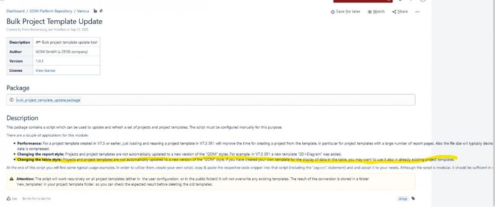

Just found a package in the myGOM package repository that may be a good solution if there are several older programs. I haven't yet tried it but brings up another issue. I can download this package manually, but if I sign in through my open instance of the software and go to the package manager i receive an error.
