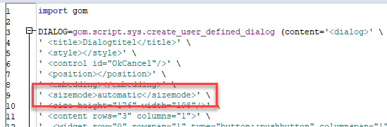

You can set the "Size" to "Automatic",
image.png.f790ecb84445514897673c8bd6d8052f.png -> image.png.666bdd5083a198ddeb469fb9349faee4.png
but as you already noticed, this only increases the dialog's size when you switch a button visible but doesn't decrease the dialog's size when you switch a button invisible.
