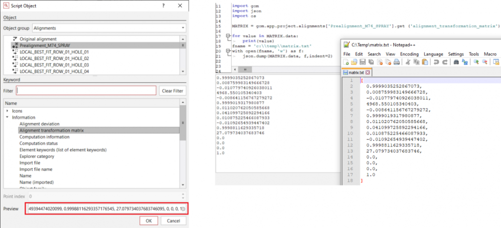

Hello Adam,
Thanks for the response.  At first glance this appears to be what I'm looking for.  I'm not familiar with scripting in GOM.  Did you create the script within GOM or did you have to use another script editor?
Also, do you happen to know what value in the matrix corresponds to what movement?  For example, when I go to Alignment->Set Matrix, I am presented with 6x options (3x for rotation and 3x for translation).  I see your script outputs 16x values...
Thanks,
Josh
Hi Joshua
I use GOM script editor. In the top menu Scripting->Edit Script. But for scripting You need to have "GOM Professional" , it is not available in free version.
This is 4x4 matrix.
Below is link to GOM Faq with some description, it is possible to extract rotation and translation components:
https://connect.gom.com/display/GKB/Definition+of+the+gom.Mat4x4+matrix

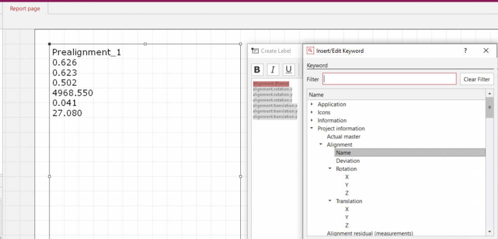

But easier for You would be to access these values via report page :
1. create report page
2. insert label
3. insert keywords

Hello Adam,
Just had the chance to try this out.  Works perfectly, thanks again for your help!
For anyone else looking into this,  I was able to move the CAD model into alignment with the mesh model in my CAD packaged (NX 12) by creating an offset CSYS based on the same absolute CSYS.
I chose the "rotate first" option and reversed the direction of each translation and rotation.  I then moved the CAD component using the "CSYS to CSYS" option.  The CAD and mesh lined up perfectly.

Hi,
one additional hint: The rotation order (which we derive from the matrix representation) is Y-X-Z. You have to respect this if you apply the rotation values in other programs. If the third party program does not allow to specify the rotation order you have to apply each rotation as a single step and afterwards you have to apply the translation (as you already mentioned)
