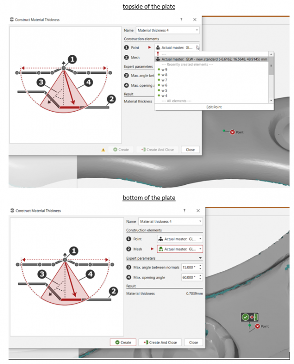

[Ti...] Posted May 26, 2022 Share Posted May 26, 2022 Hi, I would like to calculate the thickness of a plate at a particular location. For this purpose, I use the function 'construct material thickness' (Construct-Distance-MaterialThickness). Step 1: I define a dot at the top of the plate. Step 2: I select the entire mesh. Atos software will automatically decide where to put the point at the bottom of the plate. Result: Material thickness = 0.739mm and this is correct 🙂 But... How does the software calculate the material thickness? Is this material thickness the minimum/maximum/average? How should I interpret expert parameters 3 (max angle between normals) and 4 (max opening angle)? Could someone give me more information about the feature 'construct material thickness'? Thank you in advance!! Link to comment Share on other sites More sharing options...
[Na...] Posted June 8, 2022 Share Posted June 8, 2022 Hello Tinne, does the techguide/direct help explanation help you? Please sign in to view this quote. https://techguide.gom.com/en/article/cmd_inspection_create_material_thickness.html Regards, Nanno Link to comment Share on other sites More sharing options...
