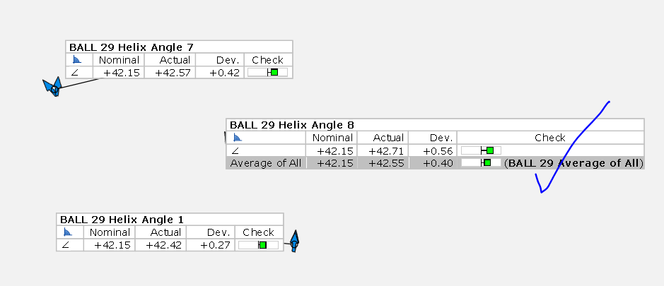

[Du...] Posted May 31, 2022 Share Posted May 31, 2022 Hello GOM team! i was wondering if there is a way how to compute the average value from specific number of inspected values Lets say i have 8 inspections of Angle relative to axis of the part and i would like to script the LABLE where i calculate average Actual value from these 8 values. I saw a note about creation of Element Groups but didnt find the way how to extract the average from the group. Thank you for your effort! Dusan Link to comment Share on other sites More sharing options...
[Ma...] Posted May 31, 2022 Share Posted May 31, 2022 I think you can use this method https://forum.gom.com/topic/456-how-to-make-a-difference-between-two-distances/#comment-1359. I use it to make the difference between two distances, but you can use to make the average between your measurment! Link to comment Share on other sites More sharing options...
[Du...] Posted May 31, 2022 Author Share Posted May 31, 2022 Thanx!! That looks like the way!! Will test it and let you know! :) Link to comment Share on other sites More sharing options...
[Du...] Posted June 1, 2022 Author Share Posted June 1, 2022 Thanx Marco! it is working! Link to comment Share on other sites More sharing options...
[Ma...] Posted June 1, 2022 Share Posted June 1, 2022 Yeah! I'm glad it works! Link to comment Share on other sites More sharing options...
