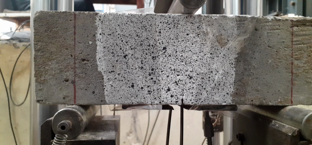

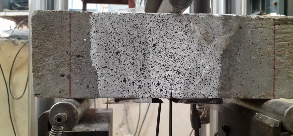

[Ab...] Posted February 19, 2021 Share Posted February 19, 2021 I am trying to export frames of video taken in a mobile phone. But when I select the entire batches of image it is only selecting only first image. I am unable to load rest of the images. I have tried importing in every format(.png, .jpg, .jpeg, .TIF) please help me i don't understand what to do? I am attaching 3 sample images. Link to comment https://qualityforum.zeiss.com/topic/100-importing-images-from-mobile-phone/ Share on other sites More sharing options...
