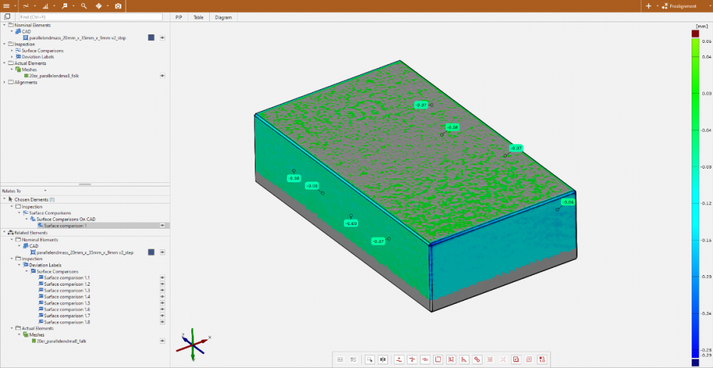

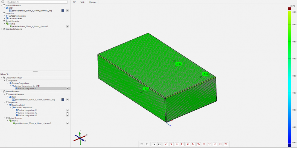

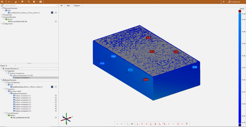

[Ma...] Posted June 3, 2022 Share Posted June 3, 2022 Hello Everyone, Im somewhat new to GOM Inspect and i tried to compare a Scan (STL-file) to a) a STEP-File from a Fusion-360 Model used as nominal element b) a STL File from the same Fusion-360 model used as nominal element However, the results where different as shown in the pictures. Can anyone explain this to me? The STL from the Fusion 360 Model and the Step of the same model of course have no deviation from each other. 1) STEP as nominal element vs Scan ... deviations areound -0.06mm 2) STL from fusion model as nominal element vs Scan ... deviations areound -0.19 mm 3) STEP from fusion as nominal element vs STL from fusion as acutal element ... no deviation (as it should be) Link to comment https://qualityforum.zeiss.com/topic/1009-different-results-comparing-step-vs-scan-and-stl-vs-scan/ Share on other sites More sharing options...

[Ma...] Posted June 9, 2022 Author Share Posted June 9, 2022 Hello, Thanks for your help. I´ve tried different alignment methods (with no other results) - however i dont think it is an alignment problem. the Scan vs. STL deviations are in range -0,15mm/-0,2mm, the ones from step vs scan in range -0,06mm/-0,08mm which indicates to me that the STL-body is smaller. since deviations are somewhat similar on both sides i draw the conclusion that the best fit auto alignment worked properly. i have done the same comparison Scan vs STL in netfabb. the results were the same to the first picture (step vs scan) in gom inspect, i have also used the same orientation from gom inspect (i saved the STL file with its orientation that produced the errors in GOM and imported that one into netfabb). all in all i cannot believe its an alignment problem Link to comment https://qualityforum.zeiss.com/topic/1009-different-results-comparing-step-vs-scan-and-stl-vs-scan/#findComment-3243 Share on other sites More sharing options...
