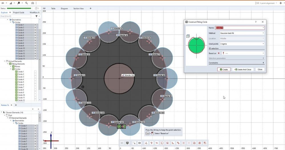

Hello,
Goal:
To determine radius of circle defined by more then 3 points. Just like a tactile measurement, fitting a circle on multiple points.
Method:
The points are not located on CAD. The points are the centers of inscribed circles like in attached example.
Question:
I have no idea how to continue. I could fit a curve but got stranded from there. I am new to GOM.
Other options: determine radius center small circles to center of object.
Hello Vincent,
to construct a circle out of the center points of other circles (or any elements which return a point like a sphere), select them all in the explorer and then RMB -> select all points of element. Red crosses will appear on the circle's centers. Then go to construct -> circle -> fitting circle in the menu. The measuring principle is "referenced construction" in this case: the actual element will be constructed with the centers of the actual circles.
In the video, I select them by dragging a rectangle with STRG+mouse:
Regards,
Nanno
Wonderful: big circle is created.
Remark:
When using RMG some unwanted elements were included. For other users make sure only to select circles. Method also works when selecting:  fitting circle first and then select circles with RMB.
Many thanks!!!
