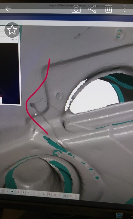

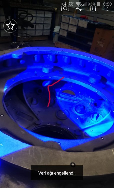

[Ve...] Posted February 25, 2021 Share Posted February 25, 2021 Hello there. The shadows formed during the shooting have a negative effect on the piece as in the photo. Where am I going wrong? How can I solve and prevent this problem. Link to comment https://qualityforum.zeiss.com/topic/112-shadow-problem/ Share on other sites More sharing options...

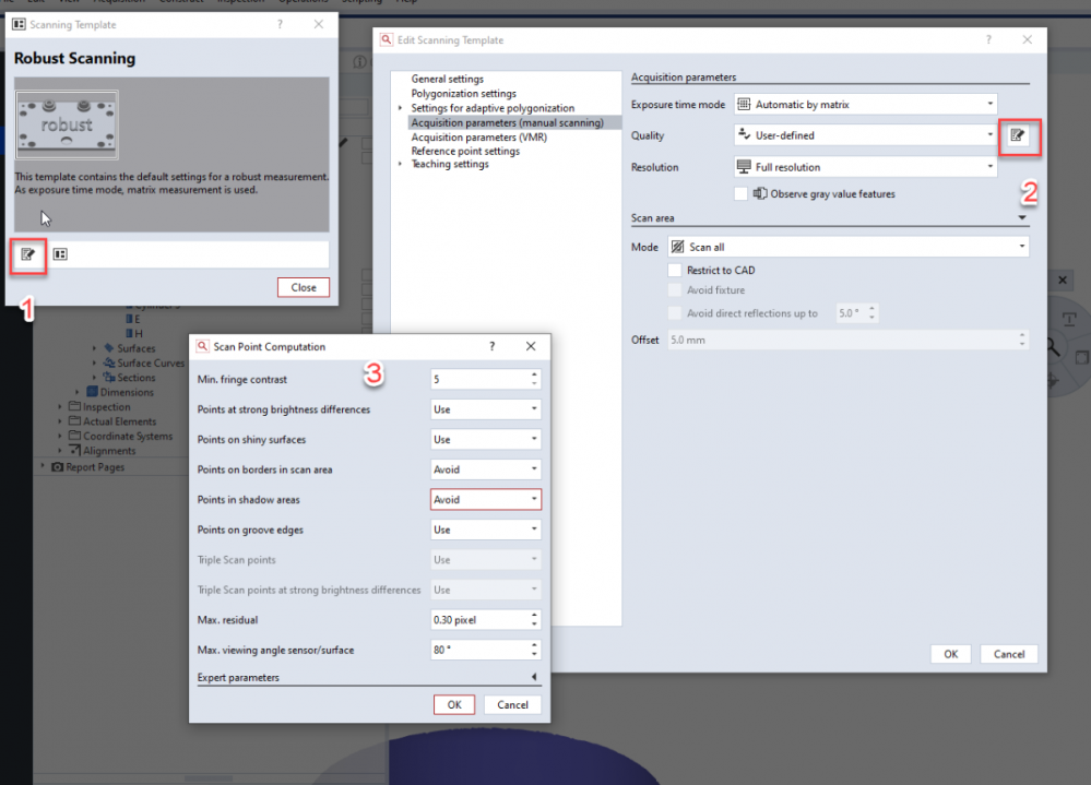

[Na...] Posted March 3, 2021 Share Posted March 3, 2021 Hello Veli, there is a setting in the acquisition parameters to avoid points at this positions. Also, during the polygonization the measurements won't be taken into account so the polygonized mesh won't show this. Regards, Nanno Link to comment https://qualityforum.zeiss.com/topic/112-shadow-problem/#findComment-330 Share on other sites More sharing options...
[Ve...] Posted March 20, 2021 Author Share Posted March 20, 2021 Thanks. Sorry this did not solve my problem Link to comment https://qualityforum.zeiss.com/topic/112-shadow-problem/#findComment-388 Share on other sites More sharing options...
