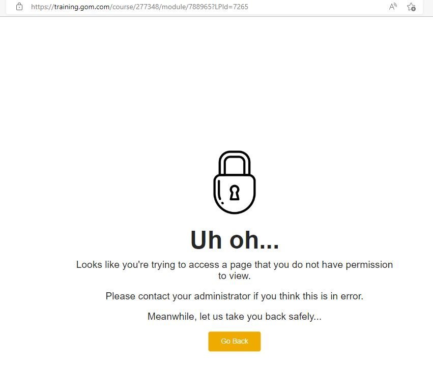

[li...] Posted July 20, 2022 Share Posted July 20, 2022 Please sign in to view this quote. It seems i have no access to this website, can you please release it to me?Thanks! Link to comment https://qualityforum.zeiss.com/topic/1163-overlay-of-2-scans/#findComment-3835 Share on other sites More sharing options...
[Na...] Posted July 20, 2022 Share Posted July 20, 2022 Hi Andy, are you logged into the training center when you click on the link? The training is called "(eLearning) 780 Starter Training GOM Inspect" and the link directs to chapter "Why Go Pro? - Trend Analysis & Statistical Process Control" Regards, Nanno Link to comment https://qualityforum.zeiss.com/topic/1163-overlay-of-2-scans/#findComment-3843 Share on other sites More sharing options...
