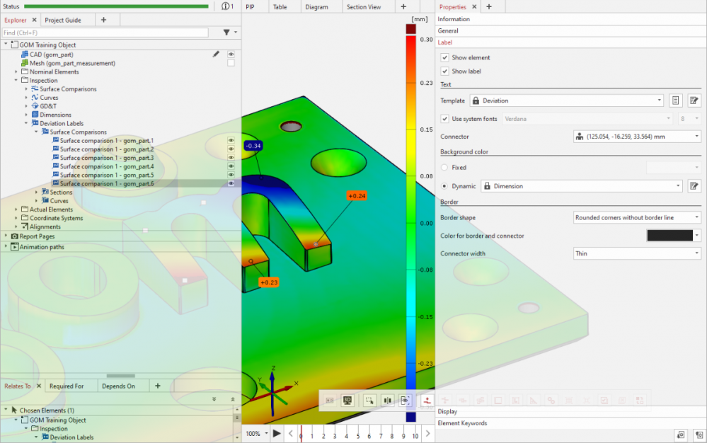

[Ha...] Posted July 18, 2022 Share Posted July 18, 2022 Hello all, I need to obtain the coordinates of probe flags, but can´t find any Option to do so. I can display the coordinates of generated points and would expect to do the same with the flags. But even after intensive research, I could not manage to do so. So does anyone have a solution for this problem? BR Hannes Link to comment https://qualityforum.zeiss.com/topic/1171-coordinates-of-probe-flags-in-gom-inspect-suite/ Share on other sites More sharing options...
[Na...] Posted July 18, 2022 Share Posted July 18, 2022 Hello Hannes, the coordinates are available when you edit the label or in the properties of the element -> label Regards, Nanno Link to comment https://qualityforum.zeiss.com/topic/1171-coordinates-of-probe-flags-in-gom-inspect-suite/#findComment-3803 Share on other sites More sharing options...
[Ha...] Posted July 19, 2022 Author Share Posted July 19, 2022 Hello Nanno, thank you for your quick response. Unfortunately it doesnt show the line "Connector" under the paragraph "Text". No wonder I did not find it... Did you change something in your configurations, or are you using a pro version? Best regards Hannes Link to comment https://qualityforum.zeiss.com/topic/1171-coordinates-of-probe-flags-in-gom-inspect-suite/#findComment-3815 Share on other sites More sharing options...
[Ha...] Posted July 19, 2022 Author Share Posted July 19, 2022 I just checked on inspect suite professional 2020. Can´t find it there neither. Which version are you using? Inspect suite 2021 or an older one? Best regards Hannes Link to comment https://qualityforum.zeiss.com/topic/1171-coordinates-of-probe-flags-in-gom-inspect-suite/#findComment-3819 Share on other sites More sharing options...
[Na...] Posted July 19, 2022 Share Posted July 19, 2022 Hello, here is a screenshot from the 2021 Inspect (Pro). Did you really select the label (grey underlined in the explorer)? Link to comment https://qualityforum.zeiss.com/topic/1171-coordinates-of-probe-flags-in-gom-inspect-suite/#findComment-3821 Share on other sites More sharing options...

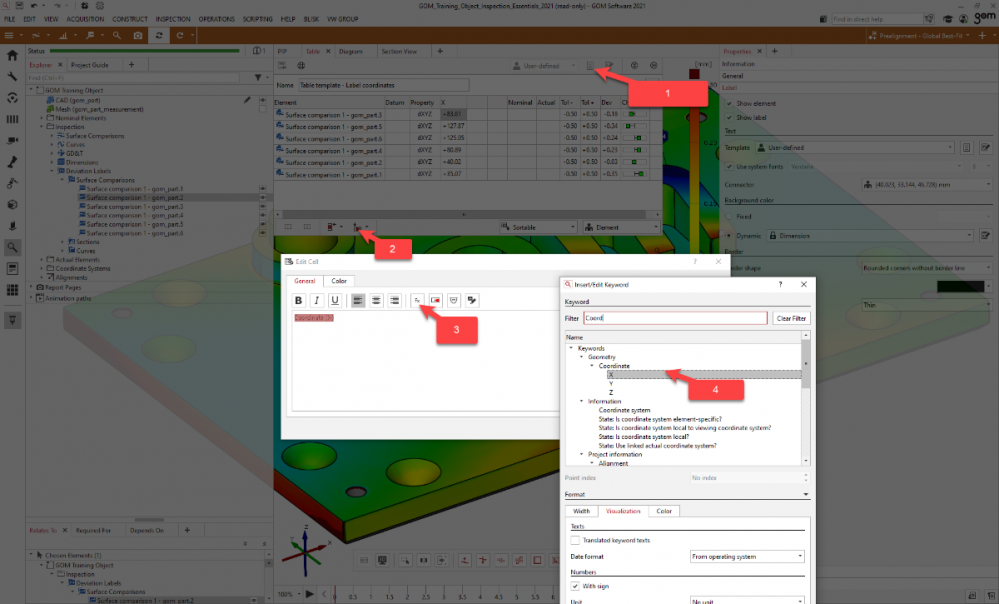

[Ha...] Posted July 19, 2022 Author Share Posted July 19, 2022 Thank you, I now managed to display it. But what further bothers me. Is there a way to also integrate the coordinates into the Table so I can export it? It ist quite unpractical since I got alot of probes. Best regards Hannes Link to comment https://qualityforum.zeiss.com/topic/1171-coordinates-of-probe-flags-in-gom-inspect-suite/#findComment-3823 Share on other sites More sharing options...
[Na...] Posted July 19, 2022 Share Posted July 19, 2022 Hello Hannes, sure, you can edit the table (1), add colums (2, click in a cell to get access to the button), enter Keyword (3), search for coordinate and insert (4). Regards, Nanno Link to comment https://qualityforum.zeiss.com/topic/1171-coordinates-of-probe-flags-in-gom-inspect-suite/#findComment-3827 Share on other sites More sharing options...
[Ha...] Posted July 20, 2022 Author Share Posted July 20, 2022 Hello Nanno, that seems exactly what I was looking for. Thank you alot. Unfortunately doesn´t work with the non pro Version. But I can work an computer with the pro version. So it does work for me. Best regards and a pleasant day Hannes Link to comment https://qualityforum.zeiss.com/topic/1171-coordinates-of-probe-flags-in-gom-inspect-suite/#findComment-3845 Share on other sites More sharing options...
