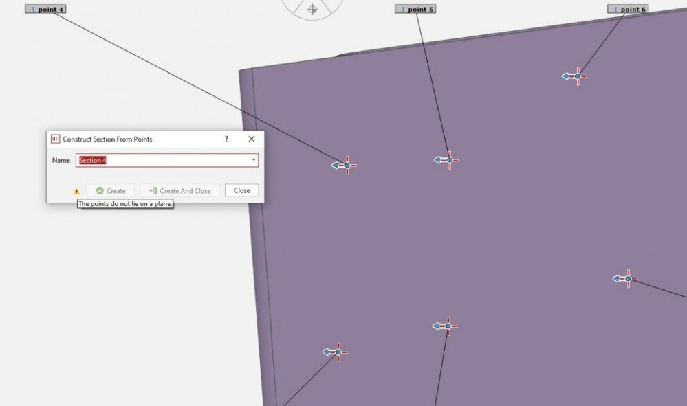

[Da...] Posted July 21, 2022 Share Posted July 21, 2022 Sometimes this informations are really really 😍 It is a plane, i even made a plane of this plane it has some flatness. I assume this have to be some special kind of points. Link to comment Share on other sites More sharing options...
[Be...] Posted July 22, 2022 Share Posted July 22, 2022 Hi, the points itself are not on an exact plane and therefore you can't create a section out of it. How can you solve the problem: Project each point on the created fitting plane and use these points for a section construction (if you really need these points as a section). Regards, Bernd Link to comment Share on other sites More sharing options...
[Da...] Posted July 25, 2022 Author Share Posted July 25, 2022 Projected points woks Thank You Bernd i do not need them now but i wanted to know more about software, it may be quite usefull i think Link to comment Share on other sites More sharing options...
