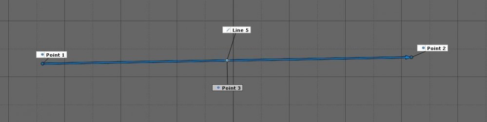

[Ti...] Posted July 26, 2022 Share Posted July 26, 2022 I created a section view of a part leaning 1 deg to the right. The two exterior points are Point 1 & 2. I then made a division point in the middle. Is there a way to make a circle sharing this center point and sharing point 1 and 2 as the outside? Link to comment https://qualityforum.zeiss.com/topic/1207-construct-circle-from-center-point/ Share on other sites More sharing options...
[Na...] Posted July 27, 2022 Share Posted July 27, 2022 Hello Tim, you can define the radius of a point-normal circle by a point: https://techguide.gom.com/en/gom-software-2021/article/cmd_primitive_create_circle_by_point_normal_radius.html Link to comment https://qualityforum.zeiss.com/topic/1207-construct-circle-from-center-point/#findComment-3925 Share on other sites More sharing options...
[Be...] Posted July 27, 2022 Share Posted July 27, 2022 The normal can't be derived from your point and you have to supply this information on your own. Link to comment https://qualityforum.zeiss.com/topic/1207-construct-circle-from-center-point/#findComment-3927 Share on other sites More sharing options...
