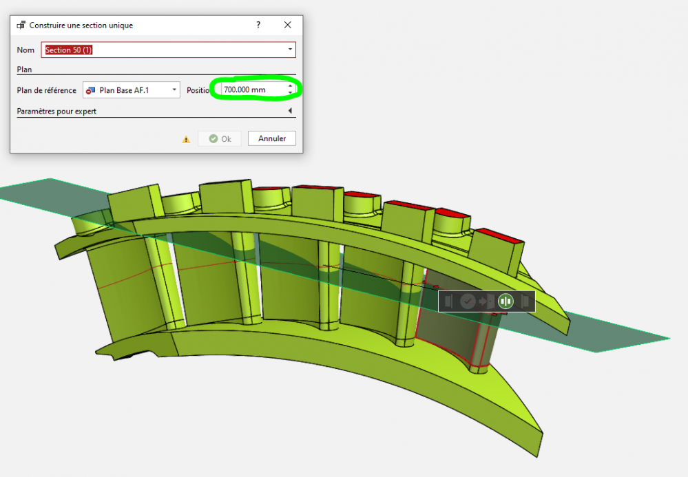

[Ju...] Posted July 27, 2022 Share Posted July 27, 2022 Hello, I'd like to now if it's possible to create some "nominal values" that we can use multiples times in others creation elements likes offset planes or sections and keep the link with the nominal value (keep the parametric effect of GOM Inspect). Like distances or offsets are entered "manually" in dialog box, i can't reuse a previous value for antoher identical construction. Is that clear enaough ? I could send some screenshots if you want... Thank you very much, Julien Link to comment https://qualityforum.zeiss.com/topic/1209-parametric-nominal-values/ Share on other sites More sharing options...

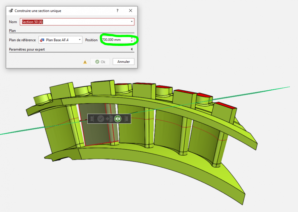

[Ju...] Posted July 28, 2022 Author Share Posted July 28, 2022 Thank you Bernd for your answer... iI already know and use frequently UDIP, but still, we need to contruct our sections first : for example in this case, I'd like there is one parameter X = 700mm and then reuse it each time I need it for instance, if I change it's value, all the construction would be updated at the same time. In that kind of parts, i need to contruct sometimes : 5 "plane sections" on each blade with 5 offsets 5 "circular sections" on each blade with the same 5 offsets it would be easier if I have 5 parameters A/B/C..E and reuse them for all the contructions... Thanks again and maybe it could be a great impovement for GOM Inspect ....2024 ? (or maybe earlier 😉...) Julien Link to comment https://qualityforum.zeiss.com/topic/1209-parametric-nominal-values/#findComment-3945 Share on other sites More sharing options...

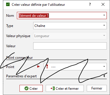

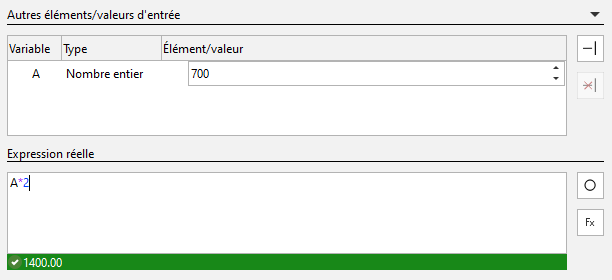

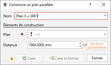

[Ju...] Posted July 29, 2022 Author Share Posted July 29, 2022 Please sign in to view this quote. Hi Bernd... and thanks again. I a already in touch with Valentin SCUBLA from French GOM Support team. for the request, I could present the things like I think they could be done : 1. Create a new kind of element like "parametric value" (eventually with different values for nominal and actual, but for me I think one single unique value is better) in the same spirit with user defined values : Then, in each dialog box where you have to put some value "manually", add a button for making a "link" with one of the parametrical value of the same type : The "must" would be the same sort of editor we can find on "user defined check" for make some basic formula with the parameters like addition, multiplication, etc... : that's it... it could be really helpful on some projects... I am really impatient to know if the Dev team could think to this possible evolution... If anyone have any question, please do not hesitate to contact me, even in private by mail. regards, Link to comment https://qualityforum.zeiss.com/topic/1209-parametric-nominal-values/#findComment-3973 Share on other sites More sharing options...
