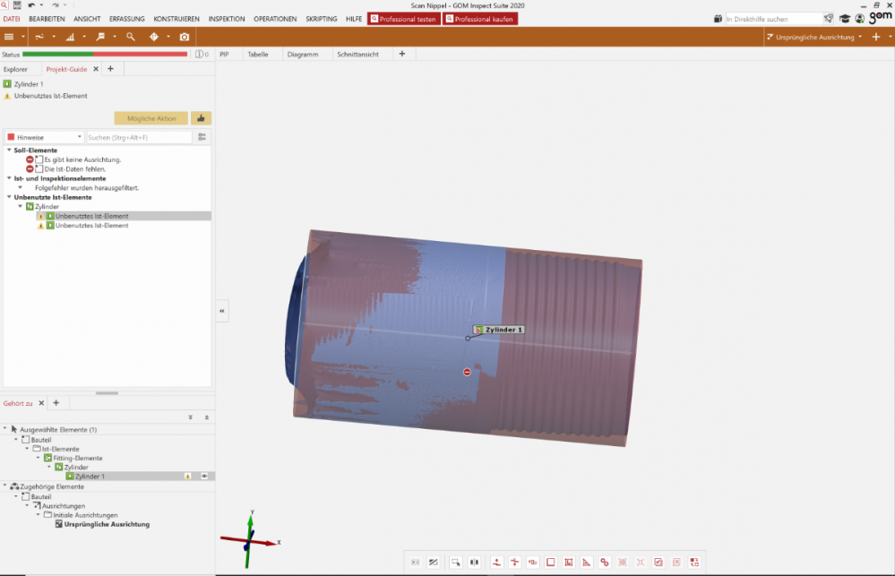

[St...] Posted March 9, 2021 Share Posted March 9, 2021 Hello, I'm new to GOM-Inspect and have scanned a threaded nipple and would like to align it first with Gom Inspect to the cylinder axis and then trace / dimension the thread with another CAD program (if that doesn't even work in Gom Inspect !?). Unfortunately, I can't get it to align the scan to me, no matter which "alignment" I choose in the menu. I would be very grateful for any help. Best regards Steffen Link to comment https://qualityforum.zeiss.com/topic/126-scanned-threaded-nipple-align-to-the-cylinder-axis/ Share on other sites More sharing options...
[Na...] Posted March 10, 2021 Share Posted March 10, 2021 Hallo Steffen, in the project guide it says "Die Ist-Daten fehlen" (no actual data). Did you import your scan data? Right now there is only nominal data like a CAD. It is possible to create pseudo actual data via Operations -> CAD -> CAD to actual mesh. Because there is no actual data at the moment, nominal and actual data can't be alligned. Regards, Nanno Link to comment https://qualityforum.zeiss.com/topic/126-scanned-threaded-nipple-align-to-the-cylinder-axis/#findComment-354 Share on other sites More sharing options...
