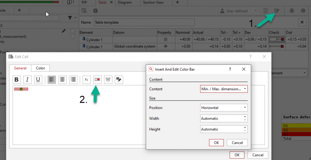

[Ti...] Posted August 26, 2022 Share Posted August 26, 2022 It appears you are required to use some sort of GDT measuring method to apply LMC or MMC. When I do this I get the below result. The check label shows the tolerance color bar, but in the report it is blank. So for the moment I'm then doing an additional Disc Caliper or something similar. Am I missing something to correct this? Link to comment https://qualityforum.zeiss.com/topic/1316-gdt-linear-size-doesnt-show-green-yellow-red-tolerance-bar-on-report/ Share on other sites More sharing options...
[Na...] Posted August 29, 2022 Share Posted August 29, 2022 Hello Tim, you can add the color bar when you edit the table template (double click on cell in the edit mode). Link to comment https://qualityforum.zeiss.com/topic/1316-gdt-linear-size-doesnt-show-green-yellow-red-tolerance-bar-on-report/#findComment-4292 Share on other sites More sharing options...

[Ti...] Posted August 30, 2022 Author Share Posted August 30, 2022 Please sign in to view this username. Thanks again as always. I'll second what Please sign in to view this username. says, a default color just like the others would seem more intuitive to me. I was simply doing another similar check to get the color output. Link to comment https://qualityforum.zeiss.com/topic/1316-gdt-linear-size-doesnt-show-green-yellow-red-tolerance-bar-on-report/#findComment-4300 Share on other sites More sharing options...
